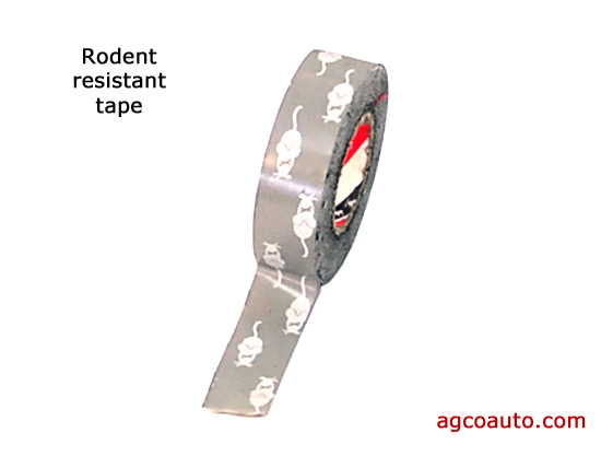

    Toyota Does not manufacture rodent tape.

    • Rodent Deterrent Tape/Tubing
      (deters chewing on wiring, this tape has capsaicin, citrus, or similar irritants embedded in it in high enough concentration that they really won't like it (products share theme of warning that contact may irritate skin/eyes), do they have to bite it to learn that it tastes terrible?)

  15. ChapmanF
    28,721
    19,019
    Most mice do not have strong brand loyalties, and will be deterred by Honda rodent tape, even in a Toyota.
