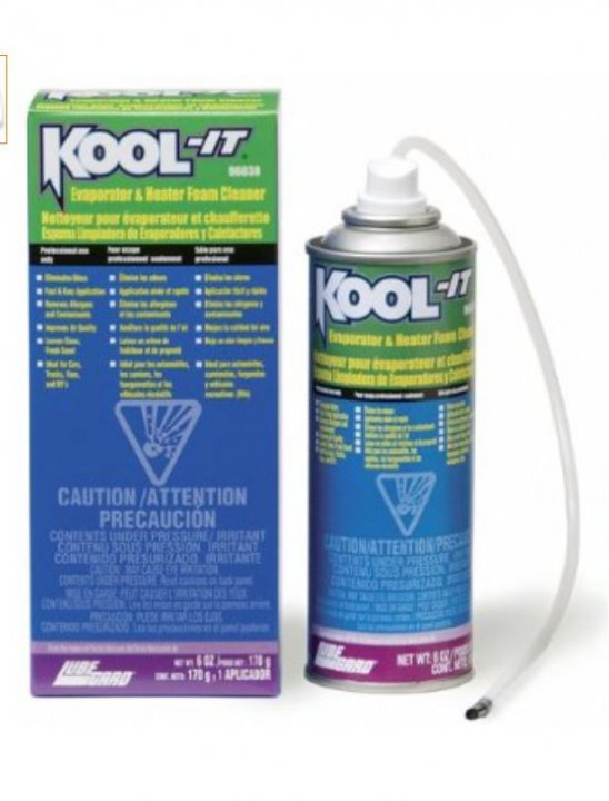

  16. phoenixgreg
    phoenixgreg Senior member
    Apr 7, 2010
    1,157
    295
    66
    Phoenix
    +1 here and all good advice. Here's a picture of Kool-It which is a spray mentioned that I used on my e-box which worked great. You should have seen the junk that came out of the drain tube! You can get this on Amazon.com for just over $12.
    edthefox5 likes this.
  17. edthefox5
    edthefox5 Senior Member
    Jul 25, 2007
    10,096
    4,837
    Clearwater, Florida
    Thats the same stuff the dealer sells. $12 is great! Thanks alot for the info!

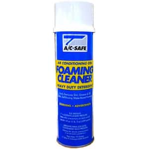

  18. Former Member 68813
    Oct 3, 2010
    3,524
    983
    US
    Would this work?
    I used it on home AC coils once.
    $5 at HD or Lowes:
  19. edthefox5
    Jul 25, 2007
    10,096
    4,837
    Clearwater, Florida
    For condenser not evaporator.
