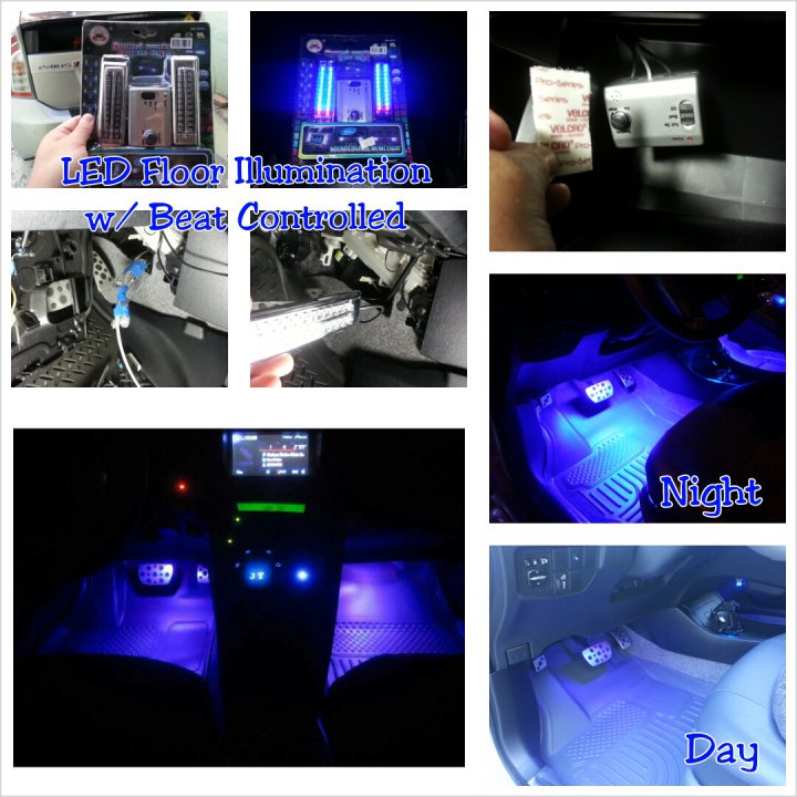

    I like my floor being lit, So I added same mod as my Odyssey "Blue leds w/Sound Effects floor illumination".
    It has 2-mode, Steady On or Beat detection.

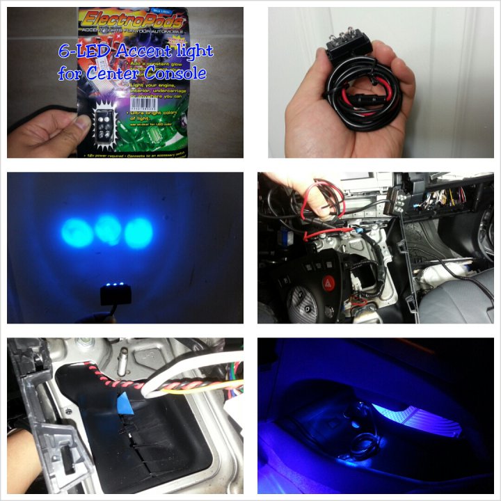

    Add some blue led for Console to go along the Floor Illumination, here you go......

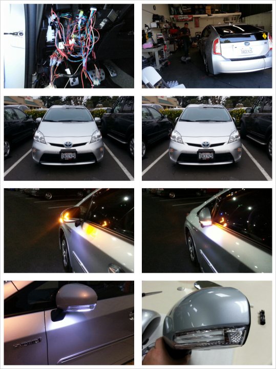

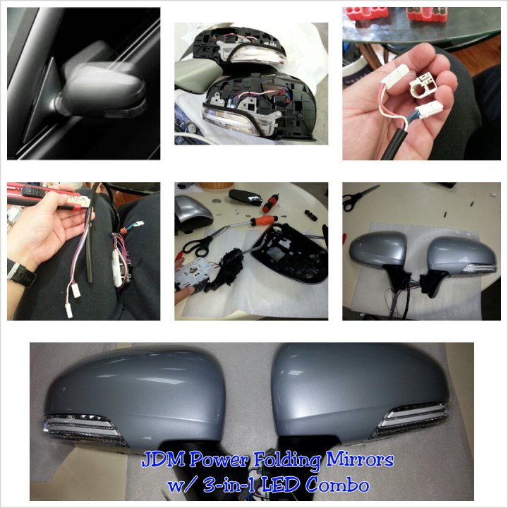

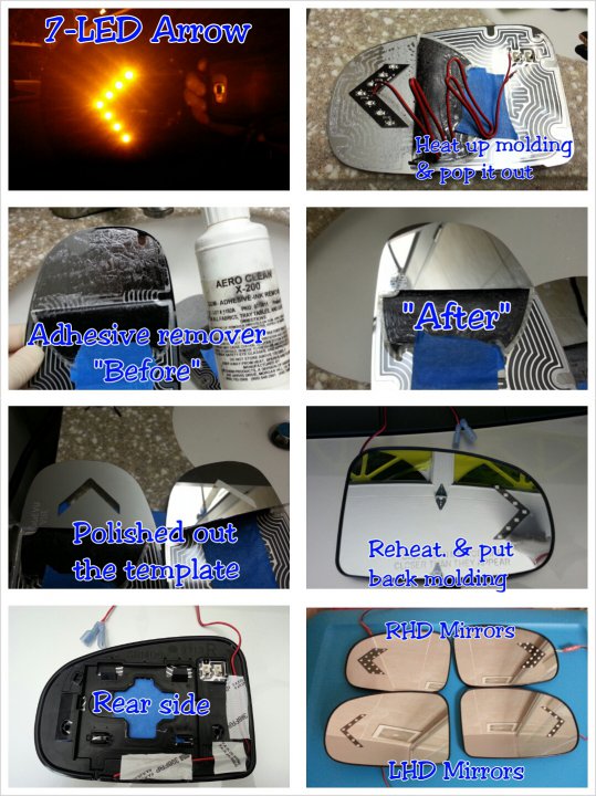

    When I signed-up PriusChat, 1st Thread I noticed was the "JDM Power Folding Mirrors". Added to my Top 3 items list, Must have mod......"Buy it now! & Tell Wife later", hahahaha.............

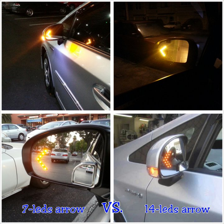

    While waiting for the from MIT Accessories, I added some LED Arrow on the mirrors, 7-Leds & 14 Leds verison.
    Due to the MIT kit, the mirrors was for RHD, it was weird when looking @ mirrors, so I changed back to LHD mirrors.

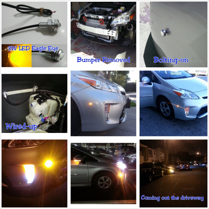

    There couple time when coming out my drive-way, cars zip right by because (I think) they unable see my front light and same time the SUV is kinda blocking my view. The Prius has straight forward turn-signals lighting. Nothing really visible/light on the front-side bumper.
    So I added Amber Eagle Eyes Led.......

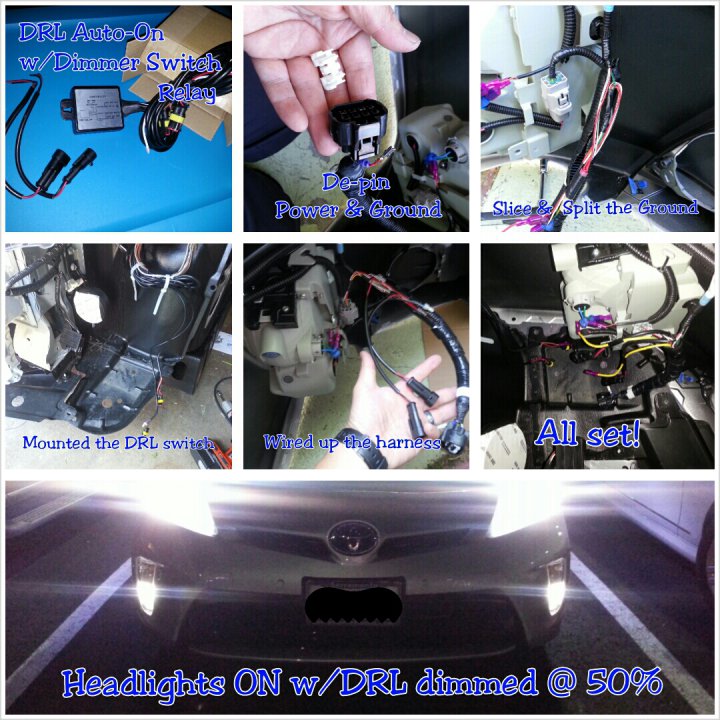

    It would be nice if DRL stays On (Dimmed @ 50% ) with Headlight On. So did little shopping, and able found a DRL Relay switch. The one I got was like 3-in-1 (Auto-On, 50% Dim, and Turn-signals) function.
    I wired all three modes, Per my co-workers (two retired police) as long the Amber & White lights are in single housing or next to each other, I should have no problem as Turn-signals.

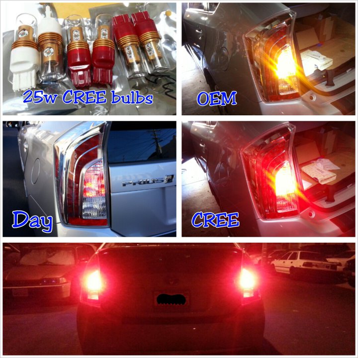

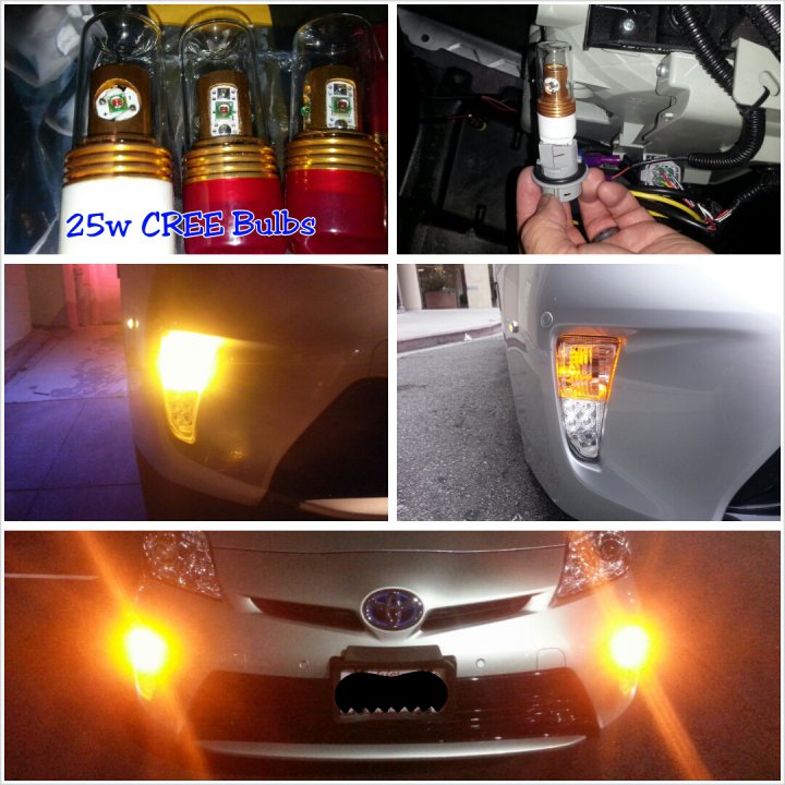

    I'm kinda "Flashlight-a-holics" I like all kinds of LED flashlights due to my work.
    So I gave it a try on some 25w CREE bulbs my Odyssey, it nice & bright the way I like it & visible in day time.

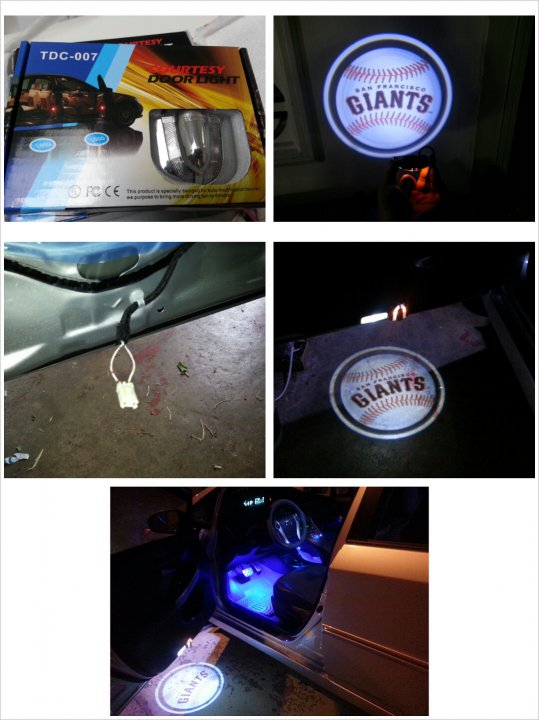

    since then I like San Francisco Giants, so I wanted add some leds to the Prius. I've custom ordered "Welcome door logo led" and PowerDecal for the Rear.

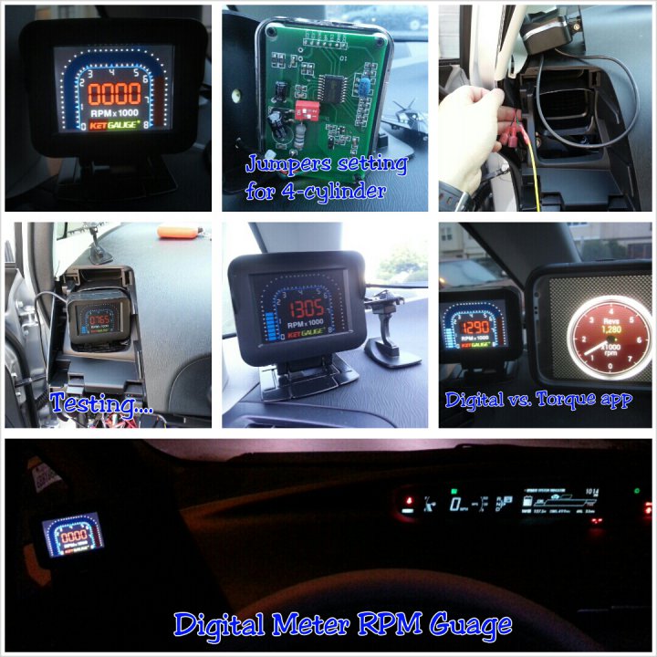

    I'm soo used to have RPM gauge all my cars, checked all kinds RPM gauges on the web, 95% is around & cylinders-type gauges. And finally found one I really like is square, small 2.5inch, thin and is Digital + Meter reading RPM gauge.

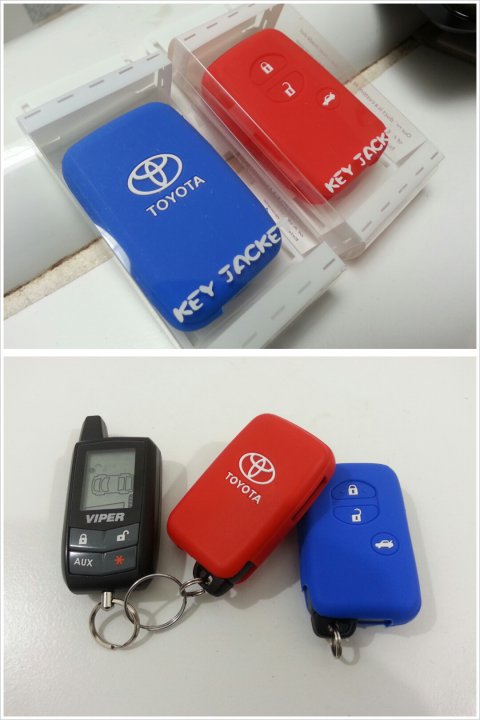

    Since I added a Viper alarm (1-click unlock all doors), and won't be using the FOB much.
    Why not get a cover for it....it was made other Toyota's but work for me.

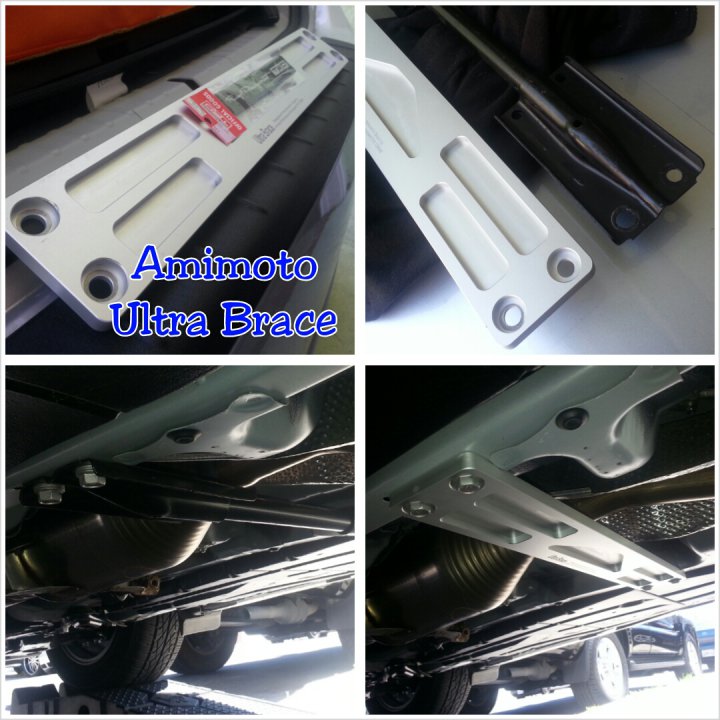

    Got a great deal from nedear88 | PriusChat locally a Amimoto Ultra Brace and a Free
    TRD emblem badge from him, and had great chat.
    Hopefully the Ultra Brace & Cusco Strut Tower Bar LHD makes the Prius handling little better.

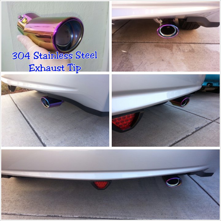

    Saw nedear88 | PriusChat have a very nice Exhaust on his Prius, Did little shopping and got a 304 Stainless Steel Exhaust Tip.
