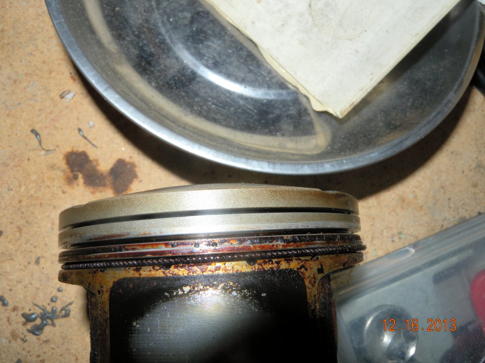

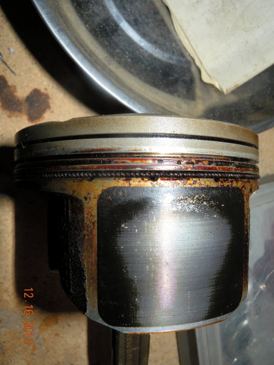

    I actually did say:
    So, we are in a partial agreement. I say partial, as there was a PC member who fixed his oil thirsty prius engine and reported back that each piston has 8 oil holes, unlike the notorious oil burner early 1ZZ-FE engine that was fitted with only 4. Furthermore, the holes were not obviously plugged even though the pistons were dirty.
    Credit: 2008 Prius - burning oil at 135,000 miles | Page 5 | PriusChat

    I researched the issue a bit more and you deserve the credit on the non-ethanol gas angle. Now that I think about it, there were a few studies that did show more piston/rings deposits with E15 and E20. Not sure of E10. One of the best studies was the Australian government sponsored E20 study done by the Orbital Engine Company in 2003 (IIRC). I downloaded it many years ago, but it's not available online anymore. There is a reference to it here:
    TR Register
    Based on the study, Australia scrapped the E20 idea, as E20 produced a slew of problems after long term use, especially in older cars. Those problems would not surface at the short term use. However, maybe with long term use even E10 has similar effects.
    Now, the point is mute as E0 is practically not available in USA anymore.
    The best we can do to mitigate the piston deposits from ethanol use is to use best oils (Dexos standard has the best piston deposit protection), cut the official Toyota OCI (probably tested with E0), and maybe even start doing the old fashioned oil flushes with oil changes.

    How do you explain the fact that flex fuel vehicles don't have serious issues with oil consumption due to deposit formation? E-85 is an acceptable (and substandard) fuel for vehicles that were equipped to burn it. To my knowledge, there haven't been recalls for oil consumption due to deposits with cars that can burn E-85.
    10% ethanol does not accelerate the formation of deposits on pistons. Deposits accumulate on pistons and rings gradually as the miles and years go by. Vehicles that have been properly maintained and driven don't have excessive carbon build up or heavy oil varnish deposits on the pistons. There are instances when car owners neglect their vehicles and don't change the oil frequently enough and drive like maniacs. The pistons in those engines are almost certainly plagued with carbon build up and heavy oil varnish deposits.
    I'm not cheer leading for E10. My Gen 2 could get 55 mpg year round with E0 instead of the 47 mpg I get with E10. But that's just the way it is.

    E85 is totally off topic, but since you mentioned, E85 is not that clear burning as some people paint it. Maybe this is why E85 use is considered severe service and short OCIs required? It can produce bad deposits:
    NASIOC - View Single Post - E85 Injector Build-up / Gunk
    As for the E10, we don't know. We do know that E15 and E20 produce more piston deposits. That have been studied and published.
    And finely, let me make the point that oil consumption via rings is a multifactorial process. You have to have a number of factors for that to happen. They include oil viscosity/oil film thickness, oil oxidation resistance, OCI, piston temp, high RPMs, high vacuum on intake stroke, piston/oil ring deposits, ring and/or liner wear, ring construction/tension, etc.
