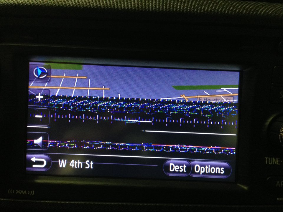

    Usually the GPS works even in the tunnel, my old Magellan did and so did the Garmin I was using until I bought this car a month ago. The issue is not only inside of the tunnel, its all around, and I'm noticing issues in other areas not related to the tunnel at all. Yesterday the screen was completely black, and today it looked like this.
    I will see what they say on Saturday.
