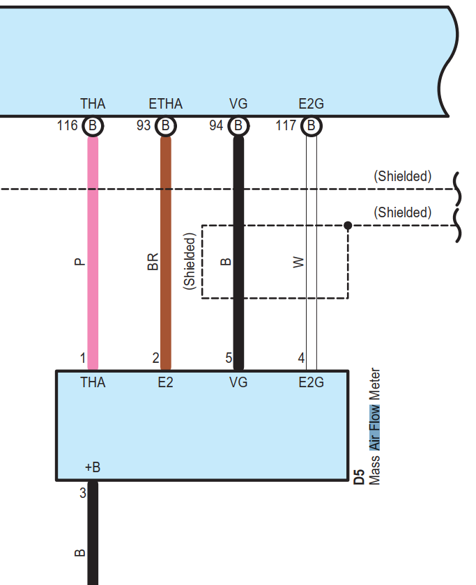

    When you look in the wiring diagrams, you will notice a number of instances like this one, where Toyota did not tie grounds together, and had good reasons they didn't.
    While Toyota's usual go-to color for a general ground is white with a black stripe, here (from this post with more details here), you will see a brown wire used as a ground, and Toyota uses a bunch of those under the hood to provide a quiet ground reference for important sensors, protected from the typical electrical noise on the general grounds. This picture also shows another, completely dedicated, white (no stripe) ground wire, also provided with a shield.
    Depending on how you "tie them together", you could end up compromising the noise isolation that Toyota designed into the system. It would also be possible to create ground loops, paths joined in more than one place and subject (think Faraday's law) to induced noise thanks to magnetic flux changes through the area inside the loop.
    When you look in the diagram at the circuits that are shielded, you will also notice that sometimes the shield may be grounded at both ends, sometimes only at one end, and those decisions (including which end, when it's only one) were also deliberately made by the engineers.
