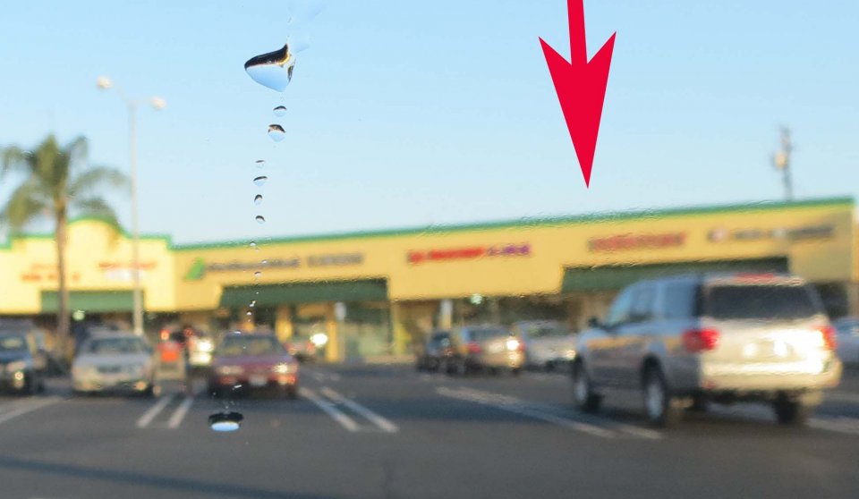

  9. plchung
    plchung Junior Member
    Apr 22, 2011
    72
    Orange County, CA
    Not sure if my experience was related to yours when I first got my PIP for 2 months. Check the attached picture. The red arrow shows the fuzzy area on the windshield (hard to see). What happened was that I brought my PIP to a body shop for body work. The windshield became like that after two days seating in the body shop. I had to go back to the body shop to ask what they did to my windshield. But they couldn't figure out. In the end, the body shop replaced a factory windshield for me.

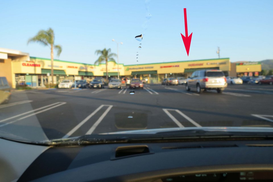

  10. plchung
    Apr 22, 2011
    72
    Orange County, CA
    picture enlarged.
