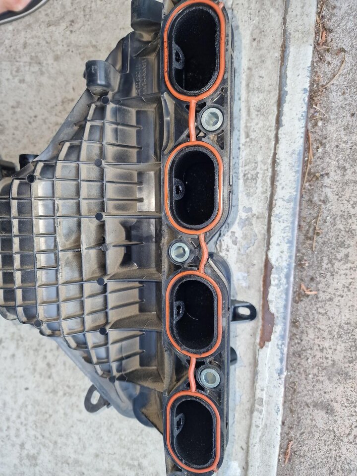

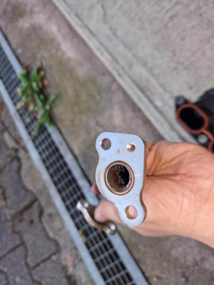

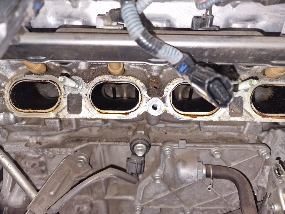

    I just did intake manifold cleaning. It is not too bad, only the cleaning part is tedious. I spend 25% of the time try to put the intake air on top of the throttle body. That spring clamp is slipery and though to open.
    The intake manifold and EGR passages are not blocked, just a bit guppy at 110k miles. Probably because my 2015 engine does not consume oil, and the EGR software are already updated from the beginning. I change the oil very 5-7k miles.
    Thanks for the video @NutzAboutBolts!
    I try to wash it with water and detergent but still tough. Probably need a brush mounted on drill.
