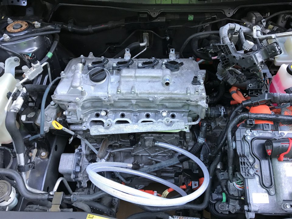

    IMG_3597.JPG IMG_3598.JPG Installed oil catch can yesterday during our Bay Area Meetup, thank you guys for the directions and helps.
    I read somewhere it is not necessary to remove the intake manifold to install OCC so I gave it a try. Once the intake snorkels and air box was off, I found there is plenty of space for me so I didn't remove the intake manifold, will do the IM cleaning some other time. I kept the original U-Shape hose in one piece, just in case I need to reverse this install. Purchased 10ft braided hose off Amazon and cut it in half so I had 5ft from PCV to OCC and 5 more ft to go from the catch can to the rubber hose via the coupling.
    After putting the air cleaner box and snorkel back on, I routed the hoses around the box, and temporarily letting it hang in the space next to the inverter reservoir with a strap tie. I want to see how much oil it collects so I'm not putting it somewhere hard for me to take the can in and out.
    Hands were somewhat dirty so I didn't take too many photos nor videos. This took me more than an hour, but for some of you, installing oil catch can without removing intake manifold can be done in less than 30 mins.

    I wonder if there will be significant cooling of the fumes in the long run of tubing on the way to the OCC, such that oil will condense out and accumulate along the walls of the tubing before getting to the OCC?
  5. CR94
    CR94 Senior Member
    Dec 2, 2014
    2,832
    1,243
    Northwestern S.C.
    Water will, too.

    I do like the below intake manifold location. I've got mine so the hose drops maybe 8" from PCV valve to the OCC, then back up to the manifold.
    It's always something you can play around with, down the road. Time will tell, if the tubing starts to act like a "still".

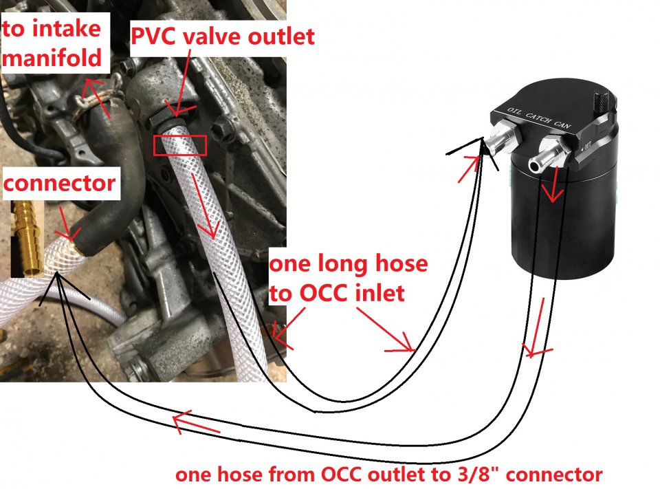

    Does it go here:[​IMG]
    Or here:
    What about cleaning the Mass airflow sensor, EGR Pipe/Cooler, throttle body, intake manifold? Does this need to be done as well?

    Answers are in Blue:
    Yes
    Also Yes. The install is half-way done here. Cut the white braided tube in half and connect your OCC. Then reconnect that black rubber elbow.
    Yes, yes, yes, yes and yes. To save time you can do these all at once to avoid having to remove the windshield wiper motor assembly and cowl again. Don't forget to clean the PCV valve, MAP sensor, and EGR valve

    Can I install the catch can without cleaning everything? My mileage is under 40K. Having a hard time finding a mechanic who will do it.
    And where do you connect the black rubber elbow? I know it's the intake manifold, but where is it in the picture? Is it what is called the ventilation hose or the fuel vapor feed hose or somewhere else?
