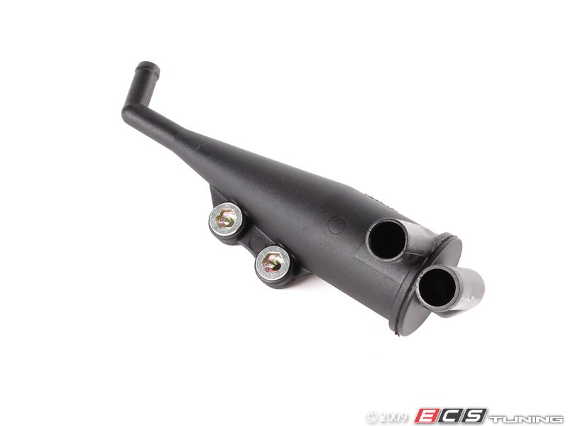

    Could this make a good oil separator? Google this BMW part No: 11 15 1 705 237 (I've ordered one for UK £9.99 from eBay)

    Looks like it might separate o.k. and then you need to drain it into something. One of the good features of the can is that it contains the residue, sort of an all in one unit.

    I'm wondering if the cyclone action would make it more efficient. It's cheap enough I think I'll give it a try.
