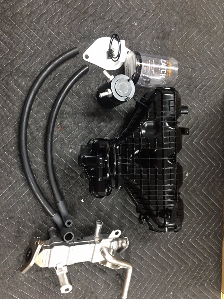

    I mean what size fittings/hoses/clamps I will need. I’m new to this, I’m cleaning everything out when I install and this will be the first time I open up an engine and do all my own work (my 2nd car, 20 y/o)

    The way that cleaned up, I want to do that to mine now lol

    Ah, read through the first few pages of this thread.

    The hose I'm using is 3/8" ID fuel line SAE-30R7 (SAE-30R6 should be fine too). It's commonly available from automotive specialty stores, for 1~2 dollars a foot. Get more than you need and cut the lines generous at first, fine tune later.
    A lot have used brass Pex splices. I used hose barb style, since that was all I could find on short notice. They are a pain to pull off though, if you make any revisions, very tenacious. I would look for the Pex style splicers, or blunt the sharp edges on the barb style. Both are available at hardware stores.
    Clamps you can also get at hardware stores, just bring along hose and test fit, if you're unsure about size. You can also get kosher automotive hose clamps, though they're a little finicky, getting the right size.
    A few zip ties?
    Colton likes this.

    What about couplings? I’m thinking of using the idea of cutting the original PCV hose in half and doing that. Two 3/8 couplings?

    Yeah, what I called splices. They're readily available at hardware stores. I used these:
    But these are preferable, especially if you ever want to pull the joint apart:
    Robert Holt, scona and Colton like this.

    Oi! Thank goodness, I purchased two of these along with two 1/2 inch ones as well just in case (before you replied). They are technically called splicers on the packaging, along with 4 ft of 1/2 inch hose and 4 ft of 3/8 inch hose along with hose clamps! Thanks for your help!! I’m installing mine this weekend!

    BTW, you don't need to clamp any of the connections. They're plenty tight, and aren't going anywhere -- there's no pressure on them.

    Just installed my OCC kit today. Took maybe 30 minutes total from start to finish. I went from underneath by removing the entire splash guard instead of removing the intake manifold to get to the pcv. I used a new OEM Toyota pcv tube, cut it in half and used 3/8 barbed splices to connect everything together instead of trying to fit 3 different sized hoses. I only used about 6ft (combined) of 3/8 fuel hose. Used the recommended Ruien OCC. Put some #1 steel wool inside the OCC for more vapor catching duty and closed it all up. Car seems to run a little smoother, but it could just be my head saying it is.
