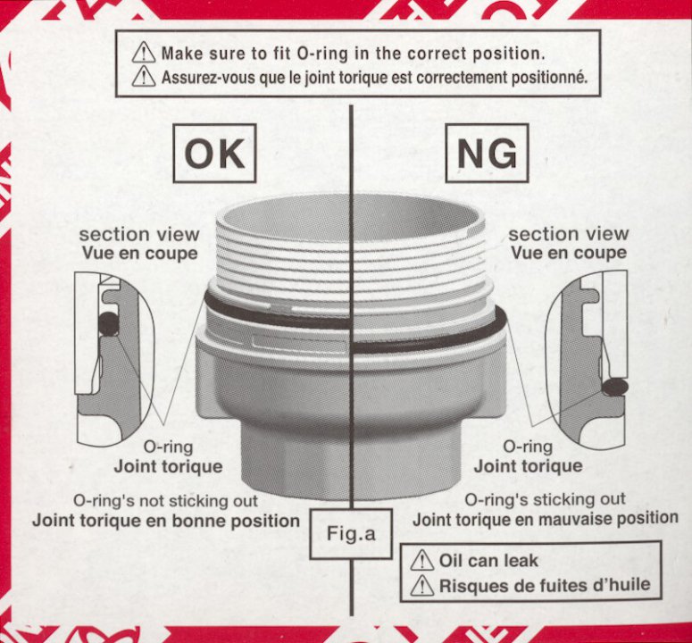

    As a supplement to the excellent PDF guide mentioned, here are a couple of nice blurry quick'n'dirty pics of the oil filter housing from a side view, showing where the o-ring goes (and doesn't go).
  7. Mendel Leisk
    61,572
    42,361
    You probably need a few more postings (5) to be able to post pics. I'll help you out:
    A scan of the box I took a few years back. Toyota (and Honda) always use that "NG", which I take it is short for "No Good".
    I've put the O-ring in the correct position, then found it up at the NG location, when next removing it. You really want to oil it good. I've thrown in the towel, going to convert to spin-on at my spring oil change.
