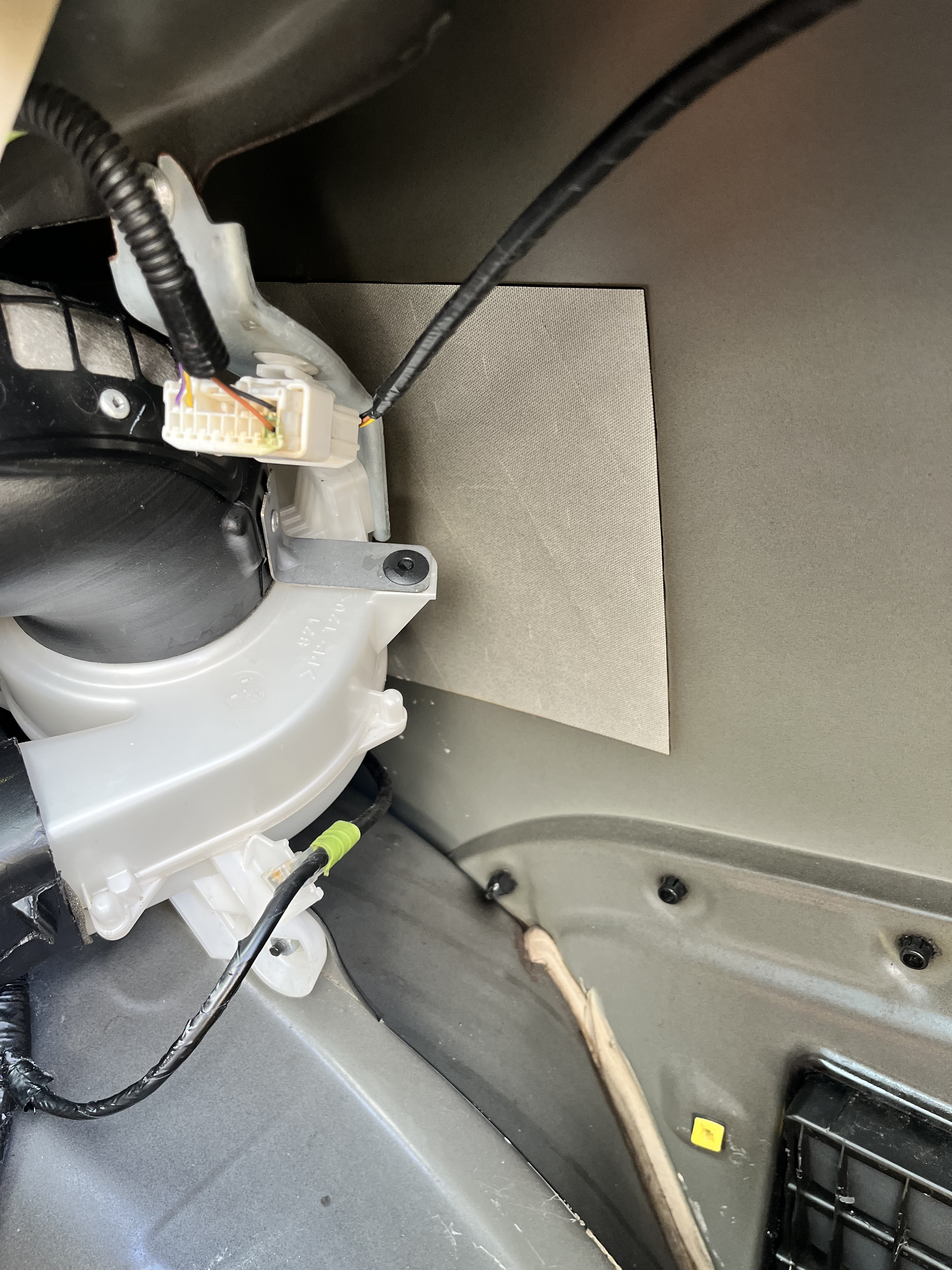

    I removed the HV battery to inspect and didn't see any obvious corrosion. I replaced the HV battery was replaced 4 years ago with the cylindrical modules from NewPriusBatttery. There was a connector near the HV fan that looked a corroded so I cut and soldered two of the 4 wires. Not sure what these wires do.

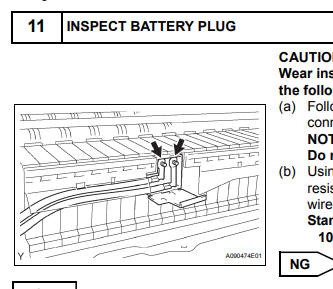

    While they cleaned the bus bars, terminals and ring connectors I probed around to see what was corresponding with the Service Manual troubleshooting steps. Got to the modules terminals in relation with the module case and found a module didn't have a similar resistance value. Decided to test for voltage and found 7.02-6.99V (error of DMM guessing) on one module negative terminal probed with the common and the V terminal probe to the case. The module is the one on the left arrow battery plug. Block 10 module 20.
    Bad Video Demonstrating Situation With I Don't Know Why I Said That Audio - YouTube
    Guessing the module is leaking and shorting out from the cell somewhere closest to the positive terminal on the other side being that module measured 7.94V. No HV battery ECU codes. HV pack charges and discharges with no observed issues on the MFD prior or using Autel MAXI AP200 and module voltage differences tested live were around 0.1V max.
    Being the pack was charged with all modules ~7.9V, I noted might be better to swap in the other HV pack and see how the vehicle performs while in the mean time letting the P0AA6 pack self discharge as well as potentially discharge with an incandescent lamp to shrink the pack length down as might be swollen due to being more charged. Reassembled and he was back on his way with future plans to I guess replace that module which I guess is leaking somehow and shorting to the case. We didn't visually observe anything out of the ordinary, though the typical bus bar and terminal nut corrosion was present. Guessing that module 20 is cracked or something with an electrolyte trace to the case on the bottom or side not visible until removed?
