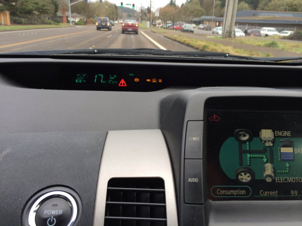

    Back in November/December I discharge/charge-cycled each module in my battery pack 3+ times after replacing 3 bad modules. I didn't get to reassemble everything and drive the car until the holidays. On short trips around town, everything seemed okay, but on longer trips (limited data here, but say 40-45 miles) I got the red triangle and some other lights (see photo). I read the code as P3024 which from what I find means Battery Block 14 Becomes Weak. I can clear the code and the car is happy until the next trip... Any advice would be much appreciated. Thanks photo (1).jpg

    Looking at your odometer at 151k miles, you probably are in a NON-CARB state.....
    Nothing else I can add to this thread, sorry.

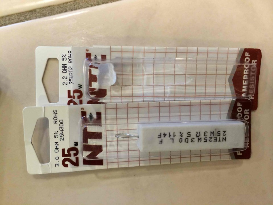

    I've tried to measure internal resistance, but I must not have a good experiment. I got a 25watt 2.2 ohm resistor to use as the load. I've got a current meter from the battery module to the resistor and a volt meter to measure voltage across the resistor during the test. I wire runs from the resistor back to the other terminal of the module. When I connect the current meter and module-to-resistor wires I see current flowing. The current is constantly dropping, but tends toward 3-3.25 A.
    Internal resistance = (V no load - V load)/current
    Battery block 14 (since block 14 threw the DTC)
    module 28: R=(7.77V-7.46V)/3.25A= 0.095 ohm
    module 27: R=(7.98V-7.62V)/3.27A= 0.110 ohm
    Block 13 (next door neighbor)
    module 26: R=(7.83V-7.42V)/3.19A= 0.129 ohm
    module 25: R=(7.80V-7.23V)/3.05A= 0.187 ohm
    I tried to wait 10 seconds to record the amperage, but I'd say plus/minus.
    Based on this, block 13 looks worse than block 14. Seems like it would be better to have a constant current load, but is there a good option for this? Is this the wrong test?

    Actually, your test looks good to me. Try the same test on battery blocks 1 and 2 and see how the voltages compare to what you've measured for battery blocks 13 and 14.
    The traction battery ECU is supposed to log a DTC when it measures a difference of 0.3V between module pairs.
