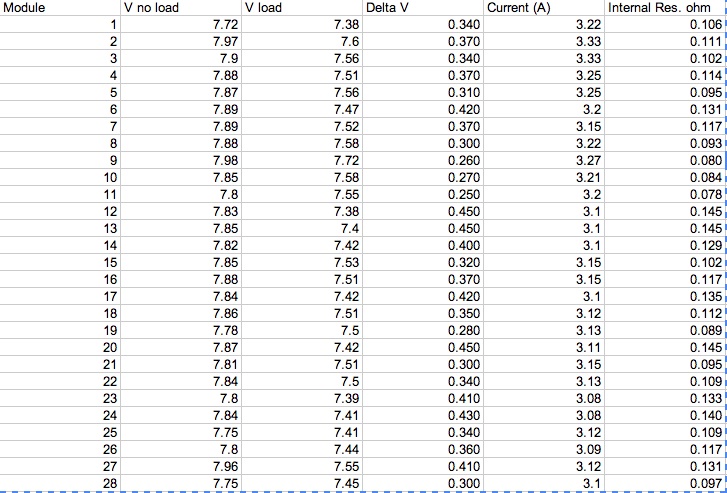

    I got some help and measured all modules:
    The test doesn't seem to be repeatable, based on the previous measurements and R calculations compared to these for the last 4 modules.
    I just received my mini VCI adaptor in the mail, so I'm going to see if that can give me some addition info.
  2. Patrick Wong
    Patrick Wong DIY Enthusiast
    Mar 8, 2008
    18,214
    6,530
    Green Valley, AZ
    Good work!
    Since we know the traction battery ECU measures voltage by module pair, please use the spreadsheet to compute the V load by module pair and then compare the 14 sets of module pairs, to see what you get.
    For example, modules 9 and 10 = 15.3V. Compare to modules 23 and 24 = 14.8V. The Delta V between those two module pairs is 0.5V. I believe that is sufficient difference for the traction battery ECU to call a fault.
    cgates30 likes this.
  3. jdenenberg
    jdenenberg EE Professor
    Nov 21, 2005
    3,961
    1,957
    Trumbull, CT
    2020 Prius
    LE AWD-e
    Your module series resistances are a bit high and have too much of a spread. Remember that the battery current can be as high as 100 amps and a resistance difference of 3 miliohms can cause a voltage difference of 0.3 volts which can cause an alarm. You can minimize the problem by matching up the module pairs so that the sum of the two resistances match as well as possible across the 14 pairs. Don't forget to get the voltages lined up a bit better before reassembling your battery.
    JeffD

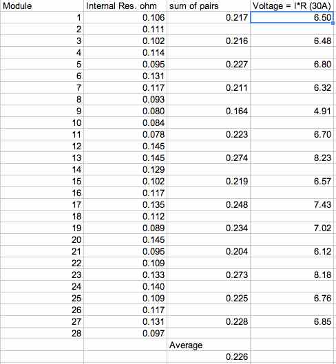

  4. cgates30
    cgates30 Junior Member
    Jan 29, 2006
    87
    This kind of goes along with what JeffD is saying, but the real world running has the battery moving higher currents which could further exacerbate the difference in voltage. I think part of the problem is the current is so low for my test (3 A compared to 30-100A when car is operating).
    I'm not sure why my resistances are so high. I've seen elsewhere that good batteries are around 0.02 ohm and mine are 5 times that. Nevertheless, if I take the sum of the resistances for each bank and multiply by, say 30A, I can see that the voltages easily differ by more than 0.3V:
    So, I can potentially make this better by pairing modules so the sum of their resistance better matches the average of the pairs. This would give me module pair voltages that will hopefully be within 0.3 V. This that correct?
    Thanks
  5. jdenenberg
    Nov 21, 2005
    3,961
    1,957
    Trumbull, CT
    2020 Prius
    LE AWD-e
    That will help along with getting all of the no load voltages lined up.
    JeffD
  6. Patrick Wong
    Mar 8, 2008
    18,214
    6,530
    Green Valley, AZ
    You could use the Data Sort function (if using Excel) to sort the table in descending order, using the Internal Resistance (ohm) column. Then, match the highest module with the lowest, the next highest with the next lowest, etc.
    However all of this cleverness will be for nothing, if in fact your module measurements are not repeatable which is what you had expressed concern about, in post #21.

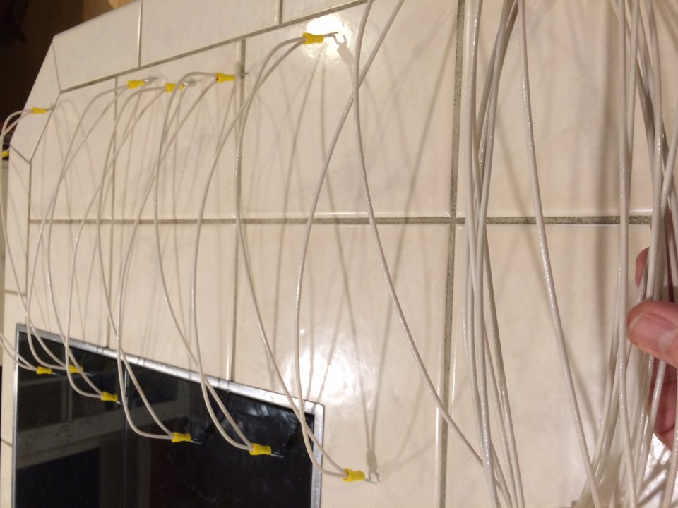

  7. cgates30
    Jan 29, 2006
    87
    When I first reconditioned the pack (replaced 3 modules and all modules got 3+ D/C cycles and then balanced the no load voltage), I used 2 of the following wiring harnesses for the balancing. My thought was electrons will travel from module to module to balance out. I've seen other such harnesses where each module is connected to a common wire traveling between all modules. Does it matter? i.e, should mine work just as well?

  11. jdenenberg
    Nov 21, 2005
    3,961
    1,957
    Trumbull, CT
    2020 Prius
    LE AWD-e
    The use of a "common" wire connection is to connect all of the modules in parallel. This allows the flow of current between the modules so that after a short time all of the modules will be at exactly the same voltage. The other option is to slowly discharge each module while monitoring the voltage to get them all to the same voltage. I prefer using the second method first to get the module voltages close so as to minimize the high current spike as dis-similarly charged modules are put in parallel.
    Your method will not equalize the module voltages and accounts for the variation in no-load voltage seen in your measurements,
    JeffD
    marcs_carhole likes this.
  12. cgates30
    Jan 29, 2006
    87
    Just trying to make sure I understand. My white harness from from +1, +2, +3, ..., +28; with a second black harness going from -1, -2, -3, ..., -28. I thought this was connecting in parallel. The common wire method I was trying to describe is somewhat shown in the picture I borrowed from another thread. Notice the black harness appears to have a single wire with all of the modules tying into it. The white wires appear to be doing what I did with my harness.
    Are these essentially the same in terms of balancing the modules?
    Thanks
