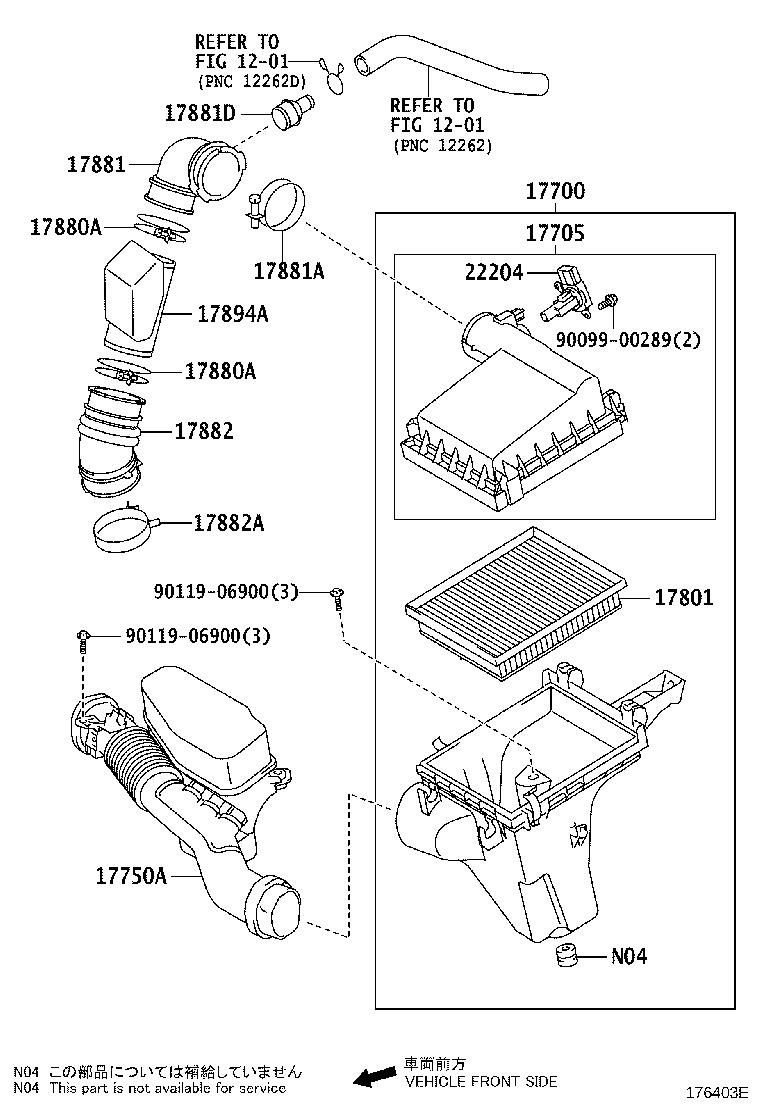

  14. ChapmanF
    28,756
    19,063
    TMR might have the simpler, critterless story: somebody checked the air filter, and let a little bit of something drop from the dirty to the clean side.
  15. Too Many Prii
    Too Many Prii Junior Member
    Aug 15, 2021
    26
    The Lone Star State
    I completely agree. They seem like honorable folks, and I will let them know what happened.
  16. Too Many Prii
    Aug 15, 2021
    26
    The Lone Star State
    Yup, precisely what happened. They should have blown out the crud before opening the filter housing.
  17. ChapmanF
    28,756
    19,063
    Sometimes I forget and picture the way Gen 3's air box is arranged, where the dirty side is below and the clean side is above, making it harder for a little bit of something to 'drop' in. But then I remember, the Gen 1 and 2 air box was not that way.
  18. dolj
    dolj Senior Member
    May 14, 2012
    8,657
    4,407
    Wellington, New Zealand
    I'm pretty sure it is that way on a Gen 2 as well as I just did the engine air filter inspection on my Gen 2 yesterday. Unless I'm not understanding precisely what you're meaning.
  19. Mendel Leisk
    61,610
    42,383
    looks like air enters from underside of air filter, flows up.
  20. ChapmanF
    28,756
    19,063
    But then it reverses at the cover and goes back down through the air box, which sits right over the throttle body.
    So if there's debris on the underside of the filter and you take the filter out and the debris drops into the box, it can end up in the engine or the MAF sensor.
    Contrast the Gen 3 air box, where the duct from the box to the throttle body comes from the lid.
    For your debris dislodged from the air filter to fall into that duct, it would have to fall up. (It would also have to get through the non-replaceable carbon filter that lives in the lid. :))
