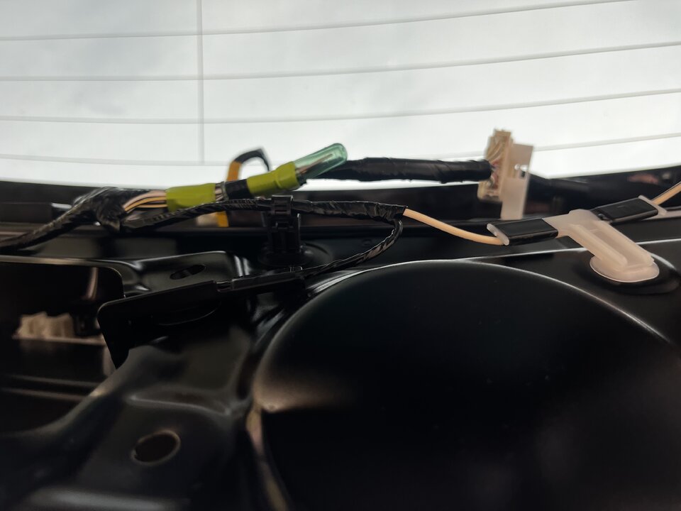

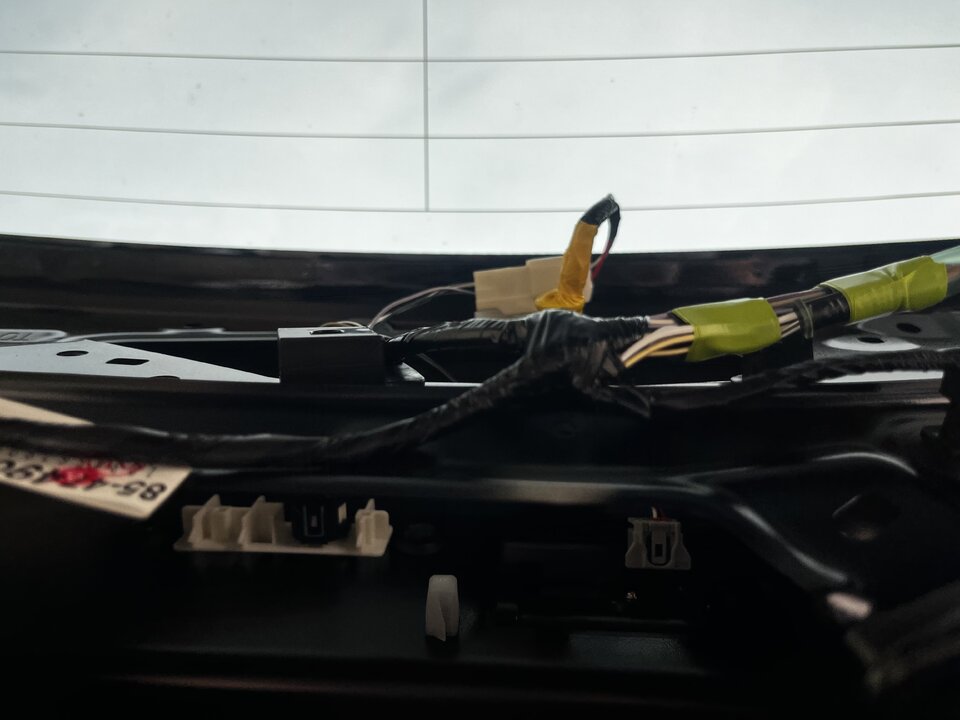

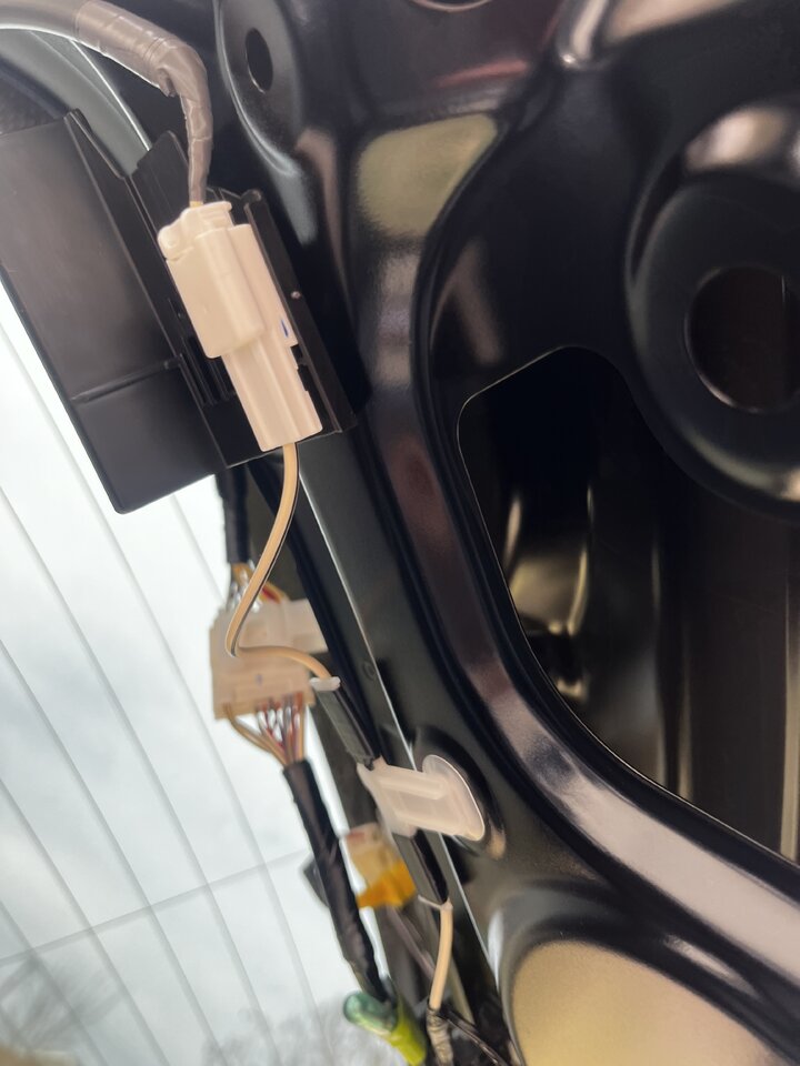

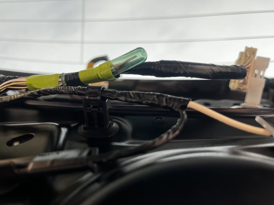

    I've been slow on stuff. I can't seem to figure out exactly where the bulbs would go for the center light bar. This is an image from a HEV Limited trim centre piece:
    I took my trunk trim covers apart to check what it looked like and grabbed some pictures. Unfortunately, they kinda suck. I will post them here in case they help anyone though:
    The wiring looks fairly the same in the XLE Limited and the SE. I assumed the bulb would go where the plunger plug with the yellow tape would go. I tried to take a picture but it's hard to see the inside. Essentially there was a hole there with what looked like a sticker cover. Me and my sausage fingers had a hard time trying to see how to remove said film other than piercing it so I left it alone. I did try shining a light inside and I couldn't see anything in the centre brake light so I am not sure if that is actually the bulb. Otherwise I don't see where the bulbs would go so I'm kinda stuck...

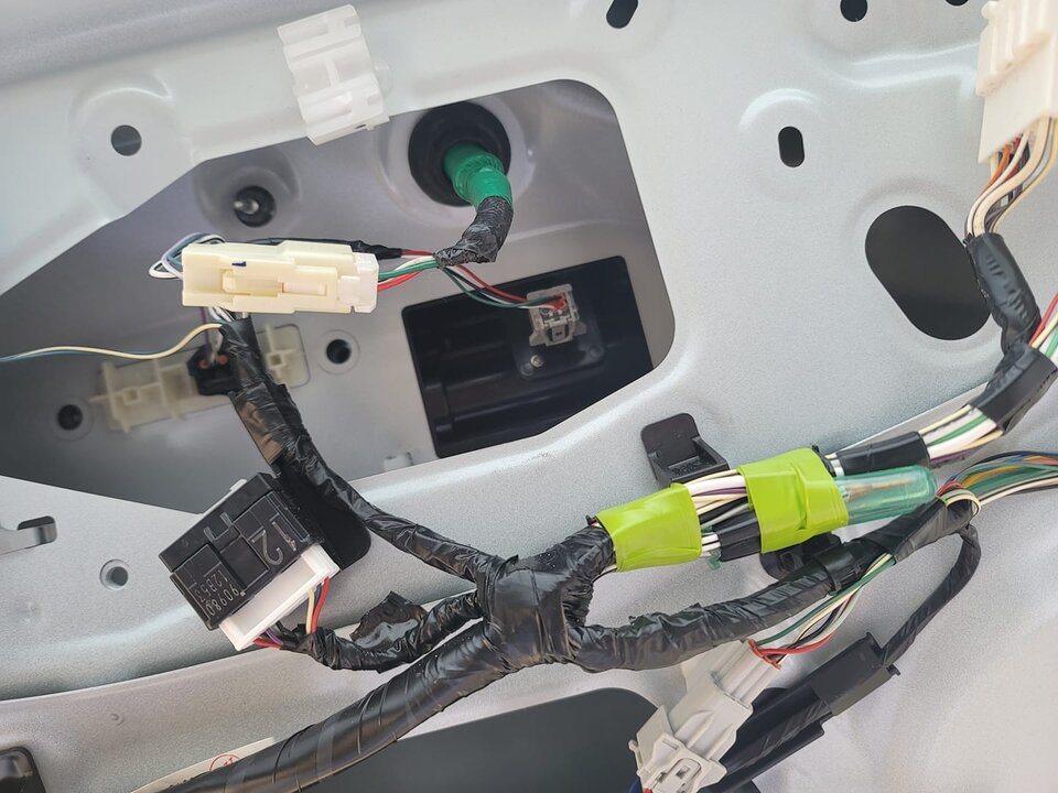

    In the other thread, @wrtboy168 posted this:
    I can see what I think is the center screw and the two white pins in the trunk but couldn't figure out the bulbs.
