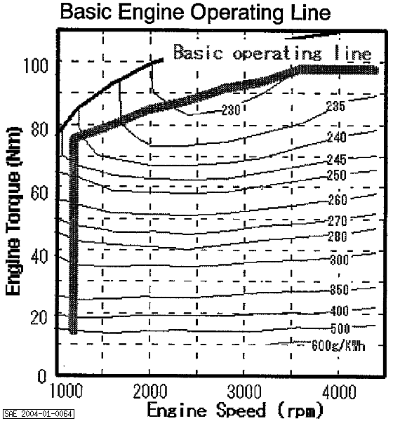

    Here is the brake specific fuel consumption map: File:Toyota 1nzfxe prius bsfc.jpg - EcoModder
    Engine itself is the most efficient between 2200…3500rpm. But as you can see from the diagram if you let the rpms drop to 1700 or go up to redline, there’s only a small difference (from 230 to 235g/kWh).
    So best is just to avoid draining hybrid battery. Unless you know that it will charge back up on downhill in that case, try to drain it enough that it can take all the available energy from downhill.
    Only thing that you can see from the map is that you should avoid those small rpms (below something like 1550rpm) but that won’t be a problem on uphill.

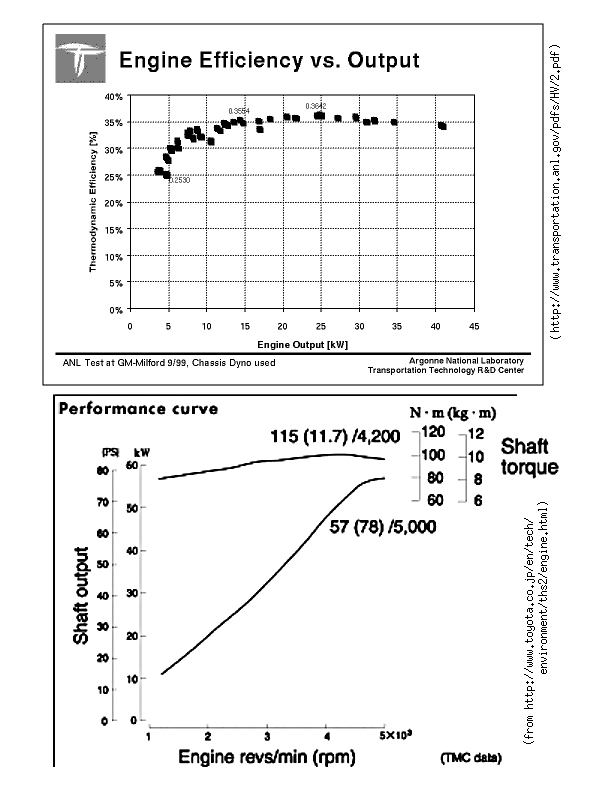

    I'm driving a 2008 with 190,000 miles on it. My mileage has dropped from about 44-45 in warm weather, to the mid-to-high 30s, and then after a Service Check to the tune of $1,400, it's dropped to the low 30s! I have a symptom that the Service Manager at Heartland Toyota dismissed/didn't address. Wish I had a tachometer; the engine seems to race going up any hills and the reported mileage drops to 12-14. Is anything wrong with that? I'm not smart enough to figure out what the above-posted charts mean.
