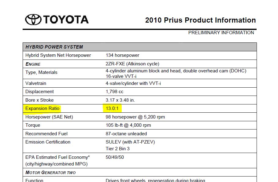

    As far as I know, the engine will go all the way up to 10:1 at WOT, but the majority of the time it's operating at much lower effective CRs.
    Toyota ZR engine - Wikipedia, the free encyclopedia
    Edited b/c of typo in wiki article ("compression" ratio for the hybrid 2ZR is really the expansion ratio)

    That Wikipedia article mention nothing about this engine's valve closing angle. To get that high compression ratio, the intake valve must close at or very near BDC. However, the VVT-i system in these engines is mechanically limited to closing no earlier than 72 (Gen2) or 61 (Gen3) degrees after BDC. This late closing greatly reduces the possible compression ratio:
    compression ratio and spark timing | PriusChat
    Can we bring up Power Mode again? | Page 2 | PriusChat

    My point isn't that the intake valves close earlier than the literature suggests, it's that the Prius isn't very different (with the exception of cooled EGR instead of a richer mixture at WOT) than a conventional engine at WOT. With that said, the Wikipedia article references a 13:1 compression ratio, which is a typo, and should be the expansion ratio. Both the conventional and Atkinson 2ZR have a compression ratio of ~10:1.
    In terms of torque, it should technically be torque at that specific speed, but most stock Toyota FE engines have pretty flat torque curves. But anyhoo, adjustments need to be made for torque unless both engines have roughly the same torque curves.

    FYI Prius C has 13.5:1 compression ratio

    See the many past years of discussions on this. Toyota was labeling that an expansion ratio back when GenIII was released, but later reverted to the more customer-familiar terminology of 'compression ratio'.

    On fake Atkinson compression and expansion ratio is the same. You posted that 13.5 can't be done and that is what C currently has

    I'll look but it is not an actual pressure but compression ratio, which is defined as the volume at the bottom / volume at the top. On real Atkinson the intake and power strokes are physically different, but on fake "modern" they are identical. Thus compression ratio = expansion ratio
  20. fuzzy1
    17,921
    10,705
    Then we have a semantic issue, using different definitions.
