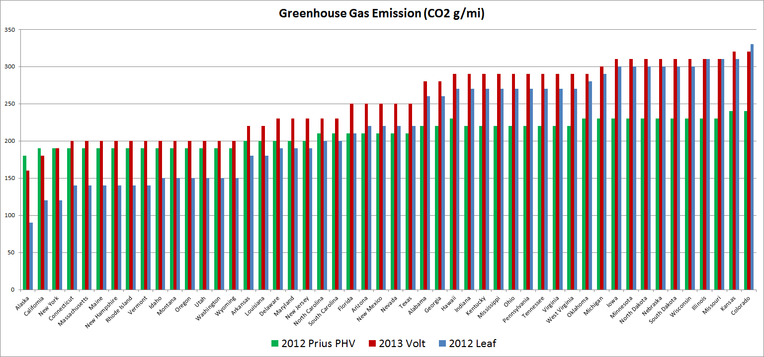

    Austingreen did the calculation here. I have not checked his math.
    PiP is not a perfect plugin for everyone and I have never claimed that. You seem so worked up with misunderstanding of my position. It is a cleaner plugin for most people while providing a midsize interior and cargo.
    See the states where PiP is cleaner than Volt.
    Yes, there are 13 states where PiP emission is slightly more than a regular 50 MPG Prius. There are 32 states where a regular Prius emit less than the Volt.

    USB, your data is all highly dependent upon driving distance, is it not?
    Also, your graph doesn't show how many emmissions a Volt or PiP emit. It shows ow much they would have emitted in 2010, right?
    To really make a good decision, based solely on GHGs, a potential buyer needs to know:
    How much the PiP emits when running on electricity in their local.
    How much the PiP emits when running on gas in their local.
    How much the Volt emits when running on electricity in their local.
    How much the Volt emits when running on gas in their local.
    How often the driver would drive beyond the EV range of the respective cars.

    That should be "How much the ... emits when running on the electricity they generate or purchase."
    Many people have the option to purchase renewables or install generation and when you can efficiently use 400kWh a month the economics further align with the eco-nomics.
