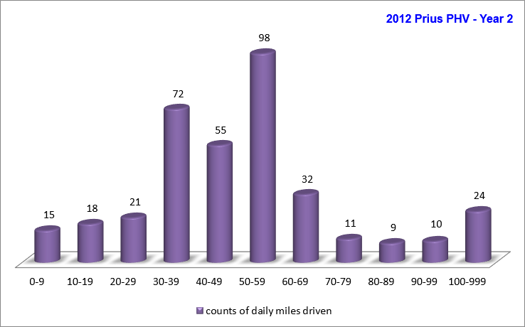

    Personally, I don't care for the tradeoffs.
    I take advantage of the cargo area in Prius on a regular basis, but that's not the biggest return. It's the MPG when not drawing from the plug-supplied electricity. Also, you consume the entire capacity quickly when driving at high speeds for more than just a little bit.
    Here's my distribution for last year... And don't forget, I live in Minnesota.
    Prius strives to be green under all conditions.
    Ford isn't actually as green overall. That choice of deeper cycling is a head-scratcher with respect to longevity too.
