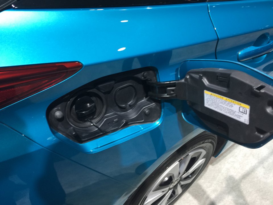

    Yeah, my cap is similar but the part it docks into is different. Mine is more like this (it's not my pic): [​IMG]

    We have ours attached to the right-side to keep it in place during charging.

    Mine is just like your pic.
    Does yours stay put?
    The problem is that the tether is designed so as to work perfectly when it's covering the charge port, but not when it is parked in the right hand space during charging.
    The tether does not swivel in any way at the cap end. Only where it is attached to the car.
    Here is another view of mine.
    Below is the position that the cap tether wants, but the cap parking holder doesn't allow.
    Seems like faulty design to me. Either the tether needs to have a vertically rotating attachment to the cap, or the cap parking place needs to be rotated by 90 degrees clockwise.

    I know that Japanese cars have an extra socket, but on non Japanese cars the space is used for parking the charge port cover and there is a receptacle for that purpose.

    Wow! I checked mine out and it looks like the receptacle that holds the cover is too large to hold the cover on mine, that's what led me to assume that the receptacle was designed for a fast charger connection.:confused:
  13. My plastic charge port cover also slides out easily... except unless I insert the plastic cover oriented at a diagonal, so that the handle part is twisted over pointing 1 o'clock and 7 o'clock. Then it slides in to the space on the right and there it stays put.

    The dangling one is the cap for the EVSE plug.
