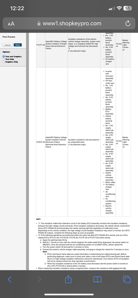

    Just used my old snapon scan tool. I had to use the generic function on it to get it as it’s not updated enough..so that’s not 100% reassuring
    It is an actual code number though, and does come up a few places when I googled it though, and does have a page on Shopkey. I would like to try on a techstream or a newer scan tool, just to verify there’s nothing else on there. Hoping to do that soon too. I attached what I found on it

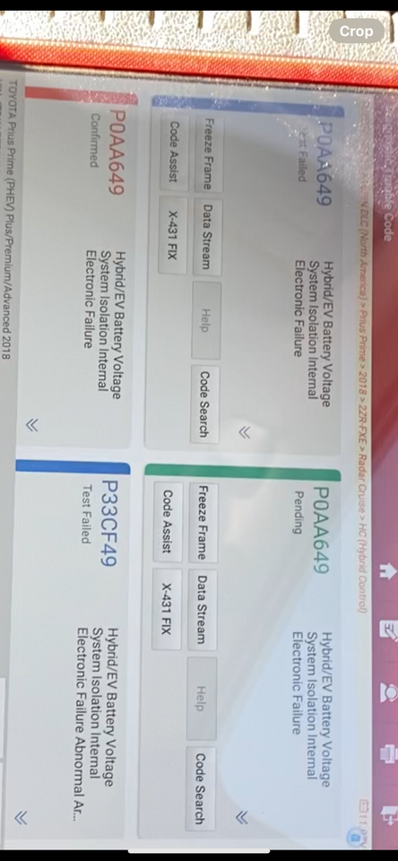

    So an update:
    These are the codes I
    Pending/Permanent:
    P33CF49-Hybrid Battery voltage isolation internal electric failure abnormal detection area
    P0AA649- Hybrid Battery voltage isolation internal electric failure
    History codes:
    B1475-AC inverter cooling system
    B1476-AC inverter load system
    I also intermittently get C1259-hv control regenerative braking system. Also gives a braking system fault message
    When the hybrid codes come up, the car will not ready on after being powered off until I clear them. Car also won’t charge. I noticed on the freeze frame, the one ecu was only getting 11v, so the thought perhaps the 12v battery was causing issues crossed my mind-but battery load tested fine with flying colours. Not to mention the fact it’s only a year old new battery.
    Once again having a heck of a time finding any info for these codes. Might swap out 12v battery with a spare I have, just to be 100% certain, but have a feeling it’ll be a waste of time. Ac seems to work okay initially, but oddly enough when it beeps/alarms out with the hybrid fault issue while driving-it actually gets colder.
    Let me know if there’s any other ideas anyone has, thanks again for any suggestions/help.

    I got these using a fully updated Launch Scanner that connected seamlessly. I’d be surprised if a tech stream would read anything different. I just don’t have access to a tech stream unless I take it to a dealer which was my last resort.
    I used to work at a dealer and I know first hand that I’d have a very hard time trusting anyone there diagnosing these cars (as they see so few of them where I am), but I just don’t have that access to tas and tech stream.
    Just based off the backstory: the compressor noise, the history codes, the low pressure on high/high low pressure, and the weird temperature variations…I’m willing to bet I just have a bad compressor or ac component that’s causing the isolation issue.
    I just hate changing parts without certainty, but maybe that’s all I can do without going to a dealer
