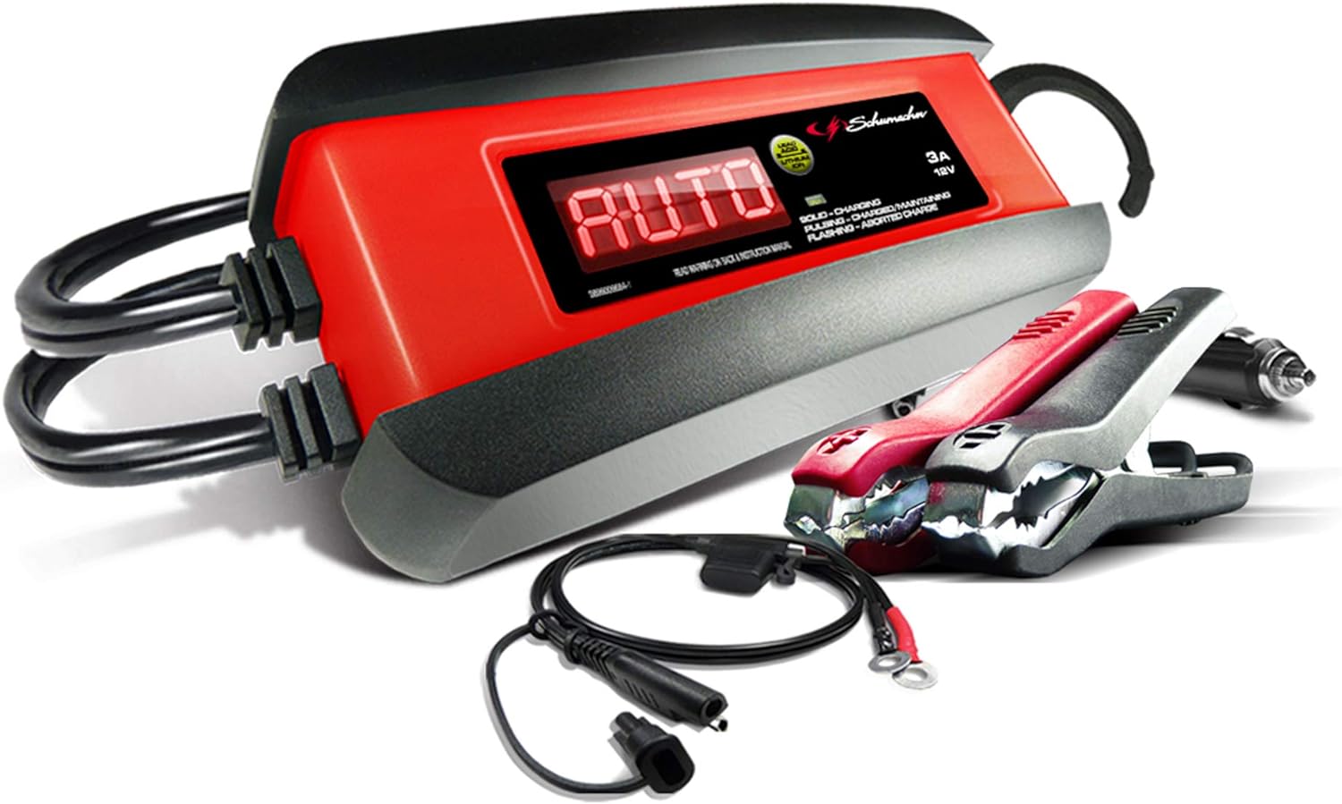

    The battery is probably okay but, given your limited driving, you may want to consider a charger/maintainer. You can leave the (included) quick connect pigtail lead permanently attached to the battery to make connection/disconnection fast and easy. They not only maintain charge level, but some also have desulfator capability. I use these for my stored/low use vehicles and never have any problems cranking them up.
