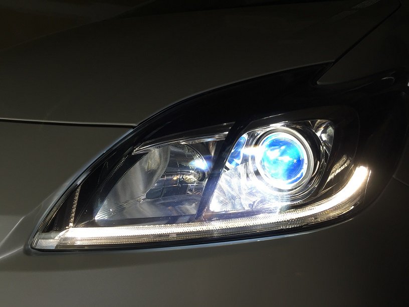

    Hey, anyone here who knows about any aftermarket headlights like the G`s headlights? The G`s headlights got the awesome looking parklight LED strip on the bottom there. That i also could use as DRL`s at day like... i could just turn on the parking light instead of the whole projector and stuff, or i could maybe wire it differently so they r on all the time or just something So yea... thats what im looking for. In Norway its not legal to install LED strips in the headlights or anything like that... (stupid rules) and the headlights gotta be E-marked/certified. Ultimatly i would buy the G`s headlights but they cost like freakin $2800. Anyone here who knows about any other AF headlights? something with good light spreading and stuff also. I got the stock 2010-2011 LED headlights now btw. I really likethe light they r giving out, much better then cars with only one projector in each light. I hav ebeen thinking about the 2012-2015 facelift headlights. But yea... something like the G`s wouldve been great. And if anybody knows about any LED strips thats E-marked that would be greatly appreciated also.

    For the record, the G's components are not aftermarket. The G's trim level (grade 7) is all OEM.
    If you're forbidden from retrofitting or modding an OEM headlight, then I don't think you're going to find a better headlight than the G's.
    Unfortunately, the G's headlights are made for RHD roads. If the police in your country are super picky, they might have issue with your blinding oncoming traffic on the left. So, even the G's lights will need to be modded to be 100% copacetic.

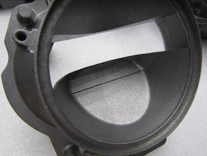

    The halogen light assembly and the G's HID assembly look similar on the outside, and I can see why you might have hopes that the internals are interchangeable. Unfortunately, they're not. On the inside these two headlights are nothing alike.
    For example, here's a photo I took of a halogen cutoff plate.
    I took it from this particular angle to highlight the rectangular hole underneath the cutoff line which is used to create the so called "squirrel finder" beam.
    This is why halogen cutoff plates are not okay with HID bulbs.
    In comparison, check out this G's HID cutoff plate.
    These two bits of hardware are no-way interchangeable. :confused:
    There are many threads on this topic. In short, there is no low cost, low effort, plug-n-play path to awesome headlight nirvana.

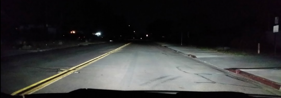

    With my JDM G's headlights, I just "adjusted them down" so I wouldn't blind oncoming traffic. I did it. It works. The problem is that sometimes you actually need to see where you're going. If you're on a dark road with no supplemental lighting it can genuinely get very scary. It's truly dangerous.
    So, what I did was I gave a set of the HID cutoff plates to a machinist friend and asked him to shave the cutoff plate flat.
    Compare this with the picture above:
    (credit @Burna J )
    Here is the BEFORE spread (adjusted down to avoid blinding oncoming traffic):
    Here is the AFTER spread on the same street:
    (see: www.priuschat.com/threads/what-did-you-do-to-ur-gen-iii-prius-today.112616/page-667#post-2433869)
    Mission Accomplished. What a relief it was. After spending $1200 USD for the lights, the additional couple of hundred for spare parts and machine work was worth it.
