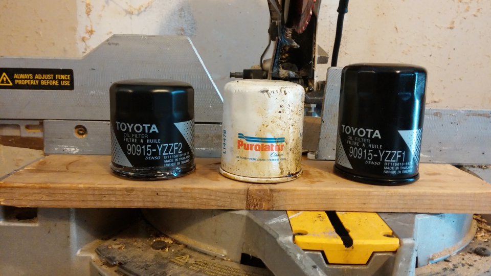

    I just changed my cvt fluid at 100k. It was dirty. Don't believe that lifetime stuff. The stuff I have been reading on prius's that are going strong into 300k + miles are people who change fluids before the recommended intervals. It makes sense. I also have been using the larger YZZF1 oil filter on my C-Two instead of the recommended YZZF2. The former does seem to keep the oil a little cleaner at 10k interval than the YZZF2 likely due to additional media surface area? Others have likely done this too I assume: prius-filters1.jpg

    I change my HSD oil every 30 K. Those toyota filters are made in Thailand and are not a very good quality under testing. I recently went to royal purple. I yous to use Mobile One which is also good just but they use a lesser quality media. Both filters are made by champion labs but the media in royal purple is of a higher quality. I also run the larger capacity like you.

    cant say I agree with using the larger oil filter, because of :-
    1, what pressure does the bypass valve open ? the same as the recommended filter ? higher, lower etc
    2, by using a filter which is not recommended for your vehicle you are voiding the warranty
    3, larger filter - more oil capacity, the dipstick is calibrated for use with a the correct filter (yes I know the difference is negligible)
    4, more oil capacity, the engine will run cooler, take longer to warm up therefore less efficiency (+ extra cost of more oil)
    not meaning to offend just my thoughts
