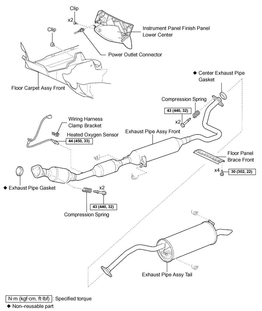

    Hate to revive, but didn't really want to start a new thread...
    Why has no one just done a header install from the Yaris?
    Yaris OEM header
    G2 Prius Header
    DC 4-1 long tube header for 1NZ-FE 1.5
    TRD Header for 1NZ-FE 1.5
    Megan Header for 1NZ-FE 1.5
    Also for the remainder of the Exhaust system:
    Yaris MidPipe and Resonator: 17410-21541
    G2 Prius MidPipe and Resonator: 17410-21500:
    I would probably do a something similar to the Nitto Mid-pipe (No Cats):
    or if I wanted to stay CA legal... Create something custom like this with Cats:
    and a custom 2" cat back...with (2) Magnaflow mufflers (one to simulate the oem resonator)
    and tips kinda like below:
    Magnaflow #35168
    $250 - DC 4-1 header
    ?? - Mid-pipe...
    $188 - Magnaflow #14714 (2@$94ea)
    $60 - Magnaflow #35168
    $500 so far plus labor and material

    Hah.. found a picture of the undercarriage of the Prius.. Gives me a better idea of the bends needed to complete this custom exhaust.

    ok so those aftermarket headers are for the yaris? it looks like the yaris manifold and the prius manifold are almost the same; only in the pix one is upside down. i think the choke point isn't the manifold, as you see from that poor car some twit flipped into a ditch, the pipe after the 2nd cat is way too thin, and from there on back its just as thin. if someone was to make a pipe from the 2nd cat back, (it'd have to be welded on) that might free up a little power. its got to be making more back pressure than you'd ever want. i think toyota wanted the cars to be very quiet, and didn't expect prius owners to actually want to drive the car. what is that 3rd cat? is it just a resonator or is it actually part of the catalyst system?
  18. Justdidit
    Justdidit LVNPZEV
    Jun 12, 2012
    1,880
    711
    75
    Carrollton, Texas
    Four Touring
    Here's a better comparison shot:
    1 is Yaris - 2 is G2 Prius both use the 1NZ 1.5, just one is the 1NZ-FE and the other 1NZ-FXE
    The Picture angles aren't perfect...but from what I can tell - Everything including the bolts and o2 sensor bung are all in the same location.
    Yaris: 17141-21130 .....................Prius: 17141-21120
    But, why 2 cats, i have no idea. I thought maybe this was a CA car with the extra restrictions, but from what I can tell, all G2 Pri have 2 cats. I don't exactly know what the diff is between a Cali CAT midpipe and the other 49states. 'Cept a couple of nitwits.. I would guess resonator in the middle of the exhaust...just has one from what I can tell on other cars i have modded the exhaust on, usually you will find a resonator just about the middle of the car (just like the picture of the 'twit-flipped-prius" lol)..then more piping then muffler. Because the Magnaflow muffler is a straight thru design, I could use two of them. This would most likely keep the noise down, but it would be a lil louder than stock. I am def NOT a fan of the muffler resonating loudly as I drive down the freeway at highway speeds. My civic did that, but then I was a lot younger bk then and I had also removed the cats. Cars aren't smogged in KS.
    I may just start with the header swap then just cut off from behind the 2nd cat and weld the Magnaflow #14714 muffler/resonator, some 2" mandrel bent SS piping, the 2nd #14714 running out to the #35168 Tips.
