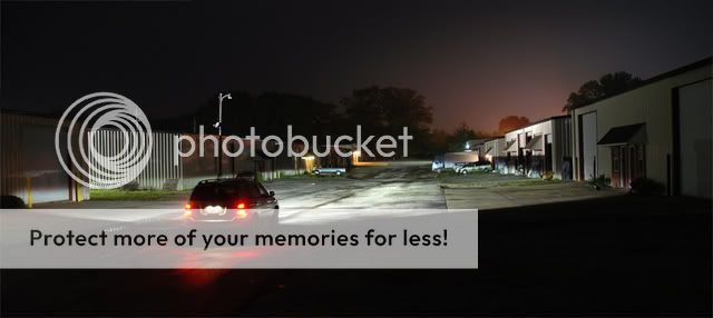

    Can you define how wide you'd like to light up? Note that the wider you go, the more chances of also blinding oncoming and / or traffic alongside. Here's a nice comparison of various projectors. You might benefit from additional "off-road" style lighting just to drive through those windy mountain roads. Here's probably what the LS430 projectors can achieve (picture courtesy of HIDPlanet.com)

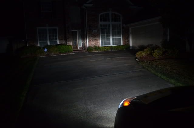

    As far as baking the headlights vs using a heat gun..I'd be super careful with a heat gun... mine gets up to 250-600º F - you can easily damage your plastic headlight lens if you leave it in one spot for too long. Damaged mine while installing the smoked vinyl overlay on my first set. The oven is super easy to do. Plenty of DIY YouTube videos as well. 200º for 10-12min in the oven then with a flat head screwdriver separate the lens from the housing. Its pretty simple.
    Retrofit is the best over most in the same $ category. eBay projectors usually have a HORRIBLE beam pattern compared to anything retrofit.
    eBay projectors below:
    VS... retrofit
    nuff said. :)

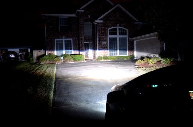

    Check out this retrofit - Just the difference in output from non-HID to HID projection is rediculous:
