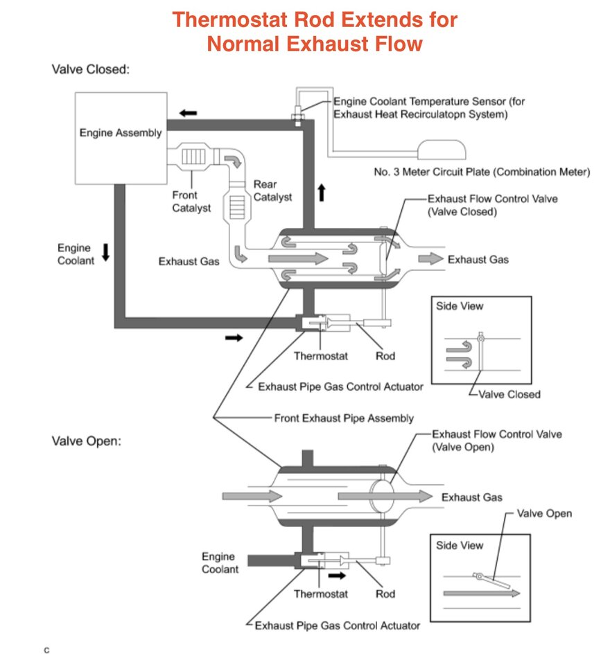

  9. rjparker
    rjparker Tu Humilde Sirviente
    Jun 6, 2008
    11,031
    6,919
    Texas Hill Country
    Exhaust Heat Recirculation System
    It has the second engine-coolant-temperature sensor which can flash the engine temperature warning light
    Link
    #29 rjparker, Sep 11, 2025
    xliderider and Gokhan like this.

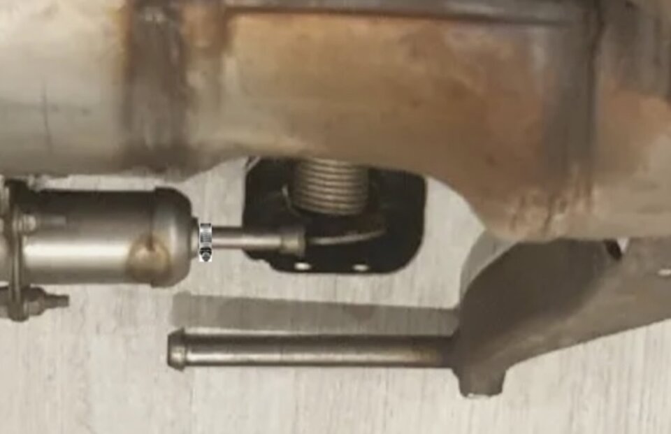

  14. rjparker
    Jun 6, 2008
    11,031
    6,919
    Texas Hill Country
    I think I would check for free movement of the "exhaust flow control valve" first. It is designed to open with increased exhaust flow even if the coolant temperature is not high enough to move the actuator.
    "After the engine-coolant-temperature rises and the engine has warmed up, the heat of the coolant expands the thermostat and the exhaust pipe gas control actuator rod extends. This opens the exhaust flow control valve to switch to the normal exhaust gas path. The exhaust flow control valve can also be opened by exhaust gas pressure to prevent insufficient acceleration..."
    But I would force it open with something like this if an actuator repair was unsuccessful.
    Gokhan likes this.

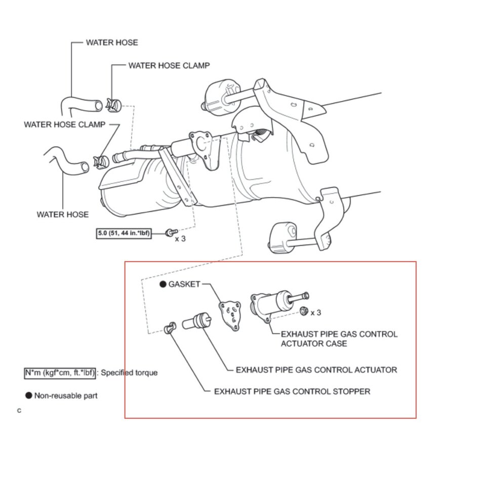

  16. Gokhan
    Gokhan Senior Member
    Oct 5, 2008
    6,707
    2,658
    Paramount CA
    You might need the following parts, too. You will certainly need the gasket.
    Exhaust-pipe gas-control actuator #17495-24010 | autoparts.toyota.com
    Exhaust-pipe gas-control actuator case #17498-47010 | autoparts.toyota.com
    Exhaust-pipe gas-control actuator stopper #17496-47010 | autoparts.toyota.com
    Exhaust-pipe gas-control actuator gasket #17499-47010 | autoparts.toyota.com
