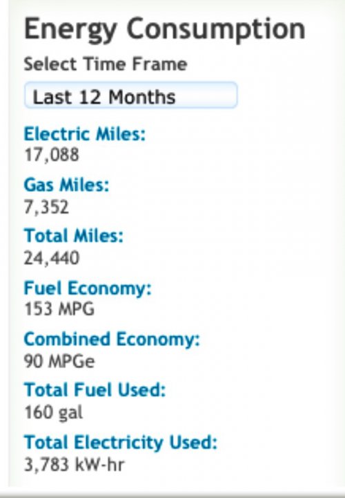

    Okay. Before the efficiency displays at MyVolt.com went haywire on me late last year, I took a snapshot of my annual efficiency between June 2012 and June 2013.
    This particular page has a pull down menu that would display either 30 day or 12 month averaged data. It always consistently showed an electric consumption number around about 15% or so more optimistic than a different 30 day display page which was consistent with my own daily records. My assumption is that the more optimistic page did not account for charging overhead. So, my numbers below are adjusted to account for additional charging overhead:
    Adjusted 132 MPGe EV
    Adjusted 84.5 MPGe combined
    46 MPG HV
    70% EV, 30% HV
    These annual averages are completely consistent and believable because I was closely tracking my monthly efficiency during that period and I was consistently getting 250-260 Wh per mile every month.
    Here is the raw data summary:

    USB, you said on a post to the Top 20 MPGe thread in February that your one year EV efficiency was 132 MPGe and your HV efficiency was 56 mpg. What was your EV/HV split and overall combined MPGe?
    As I just noted, my annual Volt averages after driving 24,000 miles were:
    46 MPG HV
    70% EV, 30% HV
