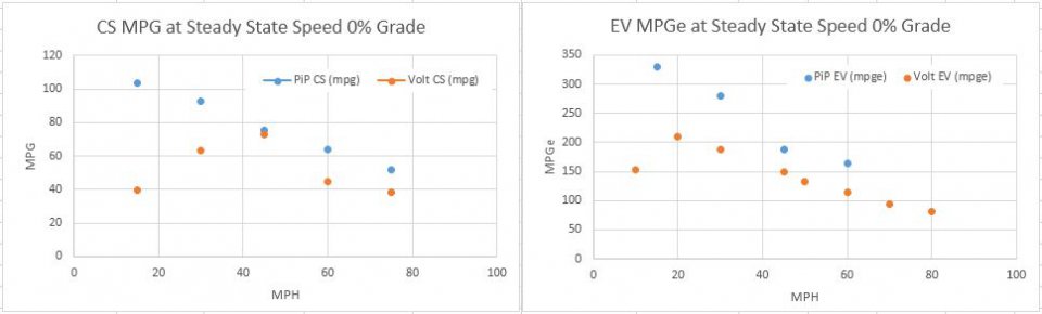

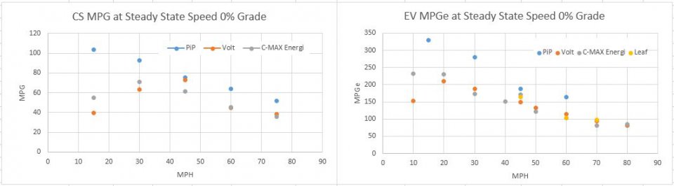

    I just stumbled over an Idaho National Laboratory document with the following test results for a 2013 Volt:
    Fuel Economy at Steady-State Speed, 0% Grade
    15 mph gets 39.8 mpg
    30 mph gets 63.5 mpg
    45 mph gets 72.8 mpg
    60 mph gets 44.8 mpg
    75 mph gets 38.1 mpg

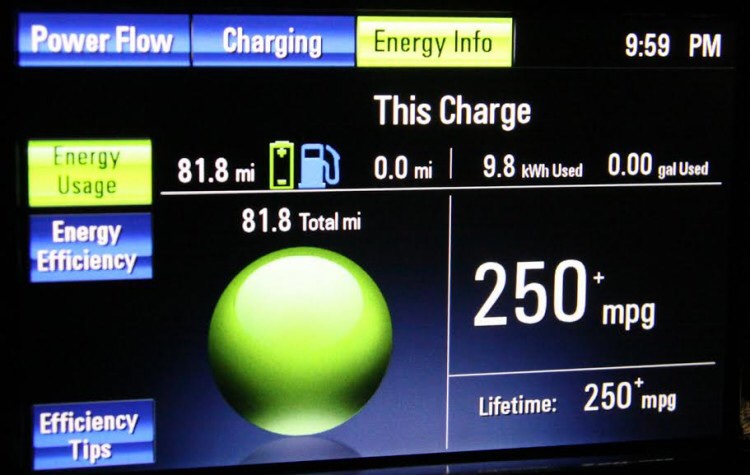

    The top MPGe list entries are supposed to be AC based numbers. For my top 10 Volt list entry (133.5 MPGe EV averaged over 1019 miles), I mostly got 130-135 MPGe EV but on one day I drove 100% EV for my 96 mile round trip to work (mostly on the highway at 55 mph) and got 141 MPGe. That includes a 500 foot elevation drop from my home in the hills of San Francisco and back so it wasn't an entirely flat road.
    An INL report says the 2013 Volt gets 187 MPGe AC (180 Wh per mile) at a steady 30 mph and 201 MPGe AC (160.8 Wh per mile) at a steady 20 mph. I know someone on the GM forum recently put his Volt on the minimum 24 mph cruise control and went 67 miles which is roughly consistent with that.
    The DC usage for the PiP seems a bit low and the DC usage for the Volt is perhaps slightly high. I've seen national lab reports showing the PiP taking 2.9 kWh AC at 72F at 240v. If 2.3 kWh DC were true that would be a 26% charging overhead which seems too high.
    The 2013 Volt INL results appear to show around 10.85 kWh DC and 12.6 kWh AC which is a charging overhead of 16%. The equivalent numbers for the 2013 PiP would appear to be around 2.375 and 2.95.
    I don't really understand the DC numbers for the PiP. In any case, if you ignore them and look at the AC charging records showing about 2.95 kWh and divide that by 11.5 miles you get about 0.257 kWh per mile. If you then divide the 2013 Volt's 12.6 kWh AC charge by that you get a Volt range of 49 miles which isn't that uncommon if you remember that 2013 Volts drive farther than earlier Volts (38 vs 35 EPA or 8.5% farther on a charge). I drove my usual 45.5 miles to work this morning and had an estimated 5 miles of range remaining. If I drove a 2013 Volt I would have had 8-9 miles of remaining range.
    I think part of what's going on is that PiP owners reporting the really high MPGe results are driving short distances at 20-30 mph. Most Volt drivers (and PiP drivers!) go farther and drive faster.
    I'm perfectly willing to believe that the PiP is somewhat more efficient at EV, especially when you include regenerative braking at city driving conditions (because it's 600 pounds lighter). I agree that it appears to be easier to achieve 160-180 MPGe while slow driving a PiP than a Volt in real world conditions. I'm less sure that the PiP is significantly more efficient in EV driving at highway speeds or in a combined driving real world commute.
    As I mentioned earlier, my own limited experience got me the same 130 MPGe EV commuting for a week in both cars over the same route although the PiP got 30% better gasoline hybrid mileage. I got several rounds of 10-11 miles of range along with a 14.3 once driving the PiP.
    In any case, the Volt can be pretty efficient at EV and do it a much farther distance or make it easier to obtain a high EV% for drivers with longer trip segments between charging.

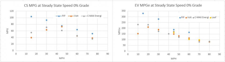

    Here is another source that seems to more or less back up the Argonne test data for DC efficiency, though gives a slight charging efficiency edge to the Volt.
    INL has published the following fact sheets as a result of their baseline testing.
    http://avt.inel.gov/pdf/phev/fact2013toyotapriusphev.pdf
    http://avt.inel.gov/pdf/EREV/fact2013chevroletvolt.pdf
    Steady State Speed DC Wh/mi (PiP vs Volt)
    10mph: NA / 219.5
    15mph: 102.2 / NA
    20mph: NA / 160.8
    30mph: 120.6 / 180.0 Volt 49.3% higher
    40mph: NA / 207.8
    45mph: 180.1 / 226.0 Volt 25.5% higher
    60mph: 204.5 / 294.2 Volt 43.9% higher
    70mph: NA / 361.6
    80mph: NA / 411.4
    Possible interpretation: It looks like the Volt has a funky operating mode at low speed that compromises efficiency? At 30mph the PiP is probably in a sweet spot of electric and mechanical efficiency (hasn't started spinning MG1/ICE yet?). At 45mph PiP has lost ground, possibly due to spinning MG1/ICE? At 60mph PiP is likely benefiting from boosted drive Voltage while Volt efficiency is falling off?
    At 45mph they give us a direct AC compare of 217 Wh/mi PiP vs. 248 Wh/mi Volt, closing the gap from 25.5% DC to 14.3% AC. Hard to say how they would compare at other speeds, as the net AC/DC efficiency appears to vary (mostly due to battery efficiency presumably).
    CD UDDS (urban cycle) DC Wh/mi vs Temp (PiP vs. Volt)
    20F:
    144.1Wh/mi+46.1mpg / 270.3Wh/mi + 46.4mpg = 38.5mpge / 33.8mpge (Volt 14% higher)
    72F: 201.6 / 258.5 (Volt 28.2% higher)
    95F: 281.9 / 337.4 (Volt 19.6% higher)
    CD HWFET (highway cycle) 72F DC Wh/mi (PiP vs. Volt)
    213.5 / 261.9 (Volt 22.7% higher)
    CD US06 (aggressive driving) (PiP vs.Volt)
    97.4Wh/mi + 57.0mpg / 364.8 Wh/mi = 48.9 mpge / 92.4 mpge (PiP 89% higher)
    All Electric Range (mi) for consecutive cycles (PiP vs. Volt):
    UDDS:
    15.7 / 50.7
    HWFE: 20.1 / 47.8
    The INL data also gives a good series of charge sustain mode comparisons.
    CS Mode MPG for various cycles (PiP vs. Volt):
    SS15mph:
    103.8 / 39.8 (Volt 161% higher)
    SS30mph: 92.9 / 63.5 (Volt 46.3% higher)
    SS45mph: 75.3 / 72.8 (Volt 3.4% higher)
    SS60mph: 63.7 / 44.8 (Volt 42.2% higher)
    SS75mph: 51.5 / 38.1 (Volt 35.2% higher)
    IMHO this is _very_ interesting data. It certainly seems from this data that the Volt transmission is optimized for about 45mph, but much lossier elsewhere? Interestingly the electric drive data seemed to indicate a similar peak in efficiency at 45mph.
    CS Mode MPG for various cycles (PiP vs. Volt) Continued:
    UDDS CS 20F: 35.7 / 27.8 (Volt 28.4% higher)
    UDDS CS 72F: 57.2 / 40.7 (Volt 40.5% higher)
    UDDS CS 95F: 44.9 / 29.2 (Volt 53.8% higher)
    UDDS 20F: 56.2 / 40.7 (Volt 38.1% higher)
    UDDS 72F: 69.6 / 46.5 (Volt (49.7% higher)
    UDDS 95F: 49.2 / 31.7 (Volt 55.2% higher)
    HWFET 20F: 64.4 / 49.2 (Volt 30.9% higher)
    HWFET 72F: 70.6 / 49.2 (Volt 43.5% higher)
    HWFET 95F: 62.6 / 41.5 (Volt 50.8% higher)
    US06 72F: 48.1 / 35.3 (Volt 36.3% higher)
    SC03 95F: 41.8 / 24.0 (Volt 74.2% higher)
    Rob

    This is very interesting data. Two testing agencies with similar data, so something is vastly separating these two cars.
    I'm still trying to comprehend what is going on with these difference. And why?
    Surly this can't be just a 'lossier' transaxle. This amount of wattage absorbed just in the transaxle would result in a lot of heat.
    The Volt has an electric ATF pump and a dedicated 'radiator' stacked with all the others in the front.
    The Prius shares coolant with the inverter and I thought just has coolant passages in the trans. case to remove the heat.
    EDIT: After reading this, I question some of your other "understandings": Contrast that with ~85% for the Honda IMA CVT and perhaps 75-85% for traditional transmissions/transaxles.
    If a 'traditional transaxle is absorbing 25% of the power flowing through it, that would be an incredible amount of heat to get rid of. Manual transaxle don't have a cooling system.
    Example:If it takes 40HP to roll at 70mph a manual 5 spd. transaxle would need to shed 10HP of heat.
    I can understand the hybrid gas differences much easier, sort of..
    Very interesting data.... Thanks for sharing it!

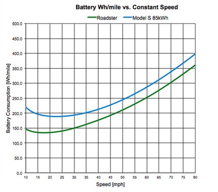

    The CS Volt curve shows series hybrid below approximately 37 mph that apparently gets more efficient when generating at higher RPM and load and then at speeds above 37 mph it curves more like the PiP (but at lower efficiency) when the Volt switches to power-split mode.
    The EV Volt curve looks roughly similar to the PiP except at speeds below 20 mph but this is mostly an artifact of the inconsistent test speeds in the dataset for the 2 cars. The PiP is very likely less efficient at 10 mph than 20 mph but there just wasn't any data collected for that in the case of the PiP. This efficiency drop under 15 mph is also true of the Tesla Roadster and Model S.
    Here's the graph from Tesla for the Roadster and Model S although it is in Wh per mile rather than MPGe so the Y axis goes from more efficient to less and the resulting data curve is flipped upside down from your national labs graphs.
    #336 Jeff N, May 28, 2014

    Here's a timely and relevant article....
    This guy drove his 2012 Volt with 52,000 EV miles under his radial belts (smaller battery like my 2011, and similar EV miles) around the perimeter road of a sports stadium and got 81.8 miles on a single charge on 9.8 kWh DC.
    He doesn't say what the AC charge was but it's probably about 11.5-12 kWh. He drove about 20-24 mph and pumped up the tires a bit excessively. End result was around 230-245 MPGe or somewhere around 143 Wh per mile (AC).
    How Far Can A Volt Go In EV Mode? How About 81.8 Miles
    #338 Jeff N, May 29, 2014

    Really cool. Relevant efficiency check would have the Fusion Energi and PiP around the same belt and the same driving style. My guess is that the PiP could possibly get 30 while the Energi maybe 40-50
