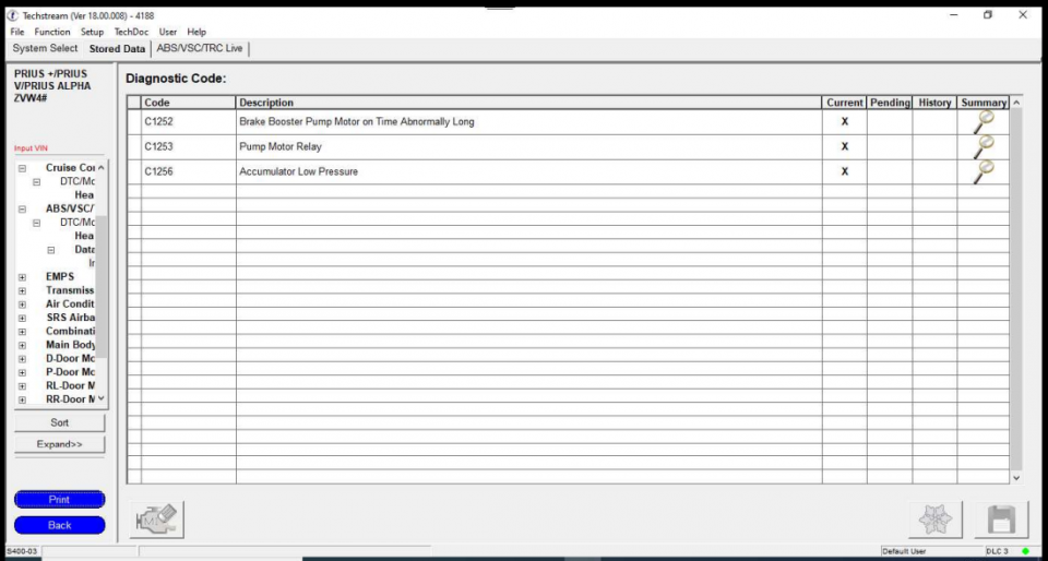

    Hi Guys,
    I know this is nothing new for this forum but i am struggling to find the informaiton and DIY pointers so creating new thread .
    ABS , traction and brake lights on . Brake is really hard and can hear the pump keep working every 10 to 15 seconds. scanned the car and found this
    Not sure where to start , if it is actuator or pump or both how do i make sure to change the faulty part .

    Change them both.

    The relay is probably complaining about high duty cycle…

    it’s just very frustrating after spending so much money on it by replacing water pump, thermostat, pcv valve, all the coolants, engine oil, cvt oil, inlet manifold and EGR cleaning and all the filters, now I have ABS issue. I believe with this kind of mileage soon there will be something else round the corner.
    I do not have repair manual and I want to spend minimum on this car, now the question is, Is there a way to find out what is wrong with abs which part needs changing I believe there is, but not sure how to check via Techstream.

    Toyota in the US replaces these free for ten years or 150,000 miles. Far past warranty due to frequent failures. They replace both parts because of the labor involved for just one which has to be repeated if the other part fails. The system has a special bleeding process and calibration best performed with Techstream.
    Unfortunately the complexity and built in ecu of the master cylinder portion has prevented a rebuilt option so far.
    You could ask the dealer if a similar “Customer Service Program” might apply.
