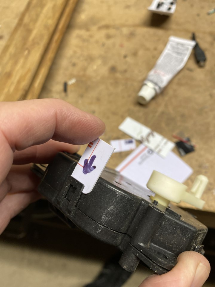

    Right. Been there and tried that with all 3 actuators on a 1998 Accord. Seem to be the same style actuators as in the Prius. Had problems with the 27 year old plastic retaining loops (the tiny ones that hold the Denso case closed once it is put back together) snapping off because they were so brittle they couldn't bend without breaking, and they need to bend to let the little wedge pass by. In the end repaired one, replaced one with a junkyard unit, and replaced the other with an inexpensive Chinese version. They all are still working a year later. The driver's side ones were trivial to get to, with the screws right there and not blocked by anything. Passenger side one was a bit harder to get to, with some disassembly needed under the glove box, and it took me a while to figure out how to unplug a few cables which were in the way (having never been unplugged - they were very reluctant to come out). That last actuator was mounted to a sort of plate and it would slide into the dash (not quite straight in, but mostly so) where it was fixed in place with a single screw and some metal tabs that engaged. Kind of like pushing a VCR tape into its slot (but with a more complex path).
    In short, much better access to all of these actuators than on the Prius.
    I also learned that one should not touch the recirc door on a car of that age. The foam rubber coating will crumble with the slightest pressure. Luckily the material beneath that held, so there is just a finger tip sized dimple in the surface and not a hole all the way through.

    What works and what doesn't for those loops, and repairs in general, seems to vary with age. The units in question were 27 years old and that plastic was so brittle that the cards would probably have broken them too. I was using a combination of fine picks and jewelers screwdrivers, one on each side, and the loops were breaking before they had been pried out enough for the wedge shaped piece to pass underneath. I did use little bits of credit cards between the two case halves so it wouldn't snap closed again. Most of the repair videos discuss fixing the sensor part, but on that car one motor was DOA and another failed during testing. I don't know of a source for new replacement motors for these, I mean, other than the Chinese copies, and if you have a whole new one of those, might as well just use it.

    Warming the plastic with a heat gun, heat lamp, etc. can also help. (Don't overdo it....)
