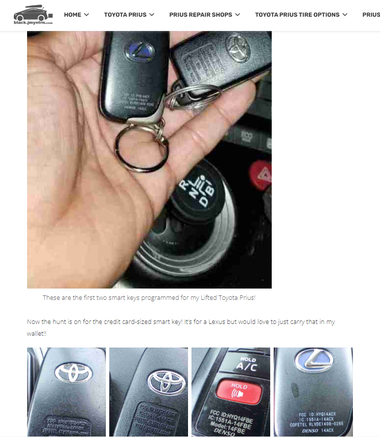

    Did you do the "all keys lost" option? I guess that's why it didn't matter they weren't virgin (confirming info from Paul's post earlier), good to know.
    Are you sure FCC ID didn't matter? If your car is an 4ACX then that's probably why they both worked as they both appear to be 4ACX. If you get a Lexus Credit Card key I think you'll be disappointed because they don't have a 4ACX version.
  4. black_jmyntrn
    black_jmyntrn Senior Member
    Oct 23, 2020
    1,729
    411
    2013 Prius Plug-in
    Hmmm, Interesting!
    Looking at all of the remotes, they are all 4ACX and I feel like I read someone eons ago someone did it, but maybe my brain remembers from when I had a GS350 and someone got it to work on that vehicle. The way it's coming back to me, my thoughts will now look into the different versions, thanks for that piece I didn't calculate into the plans.
    The plan was to stumble upon a swapmeet where there are multiple tables of returned Amazon items for sale and I'm sure there will be one filled with key fobs... heh, figured the way things go for me, I'll literally stumble upon 5-10 and I can pick the version I assume should work.
    to answer your question, yes, all keys lost. heh, literally that was the situation to only find the one key 25mins after not completing the process and locking myself out of the immobilization system. Another Prius owner in the house thought it was theirs and wondered why it didn't work on their car. ha! They thought the batter was dead! I thought I tried the Gen 4 Prime key but now I remember I didn't want to go through the process to add the key back to that car. I figure it wont hurt to try and program another version, the way I've realized Toyota works is they can have one part have multiple part numbers specific to individual cars but things all still work together because of their secret sauce.
    You can see the fobs and their IDs on this blog article I wrote about programming the prius smart key system with a Lexus key fob.
    n
    now I feel I need to go back and look at all of the fobs I have, something says one wasn't the same that was programmed and it wasn't the Prime key... this after typing all of this out.
