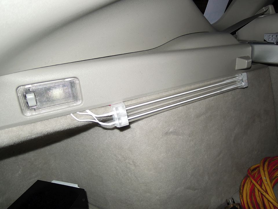

    you can also try CCFL strips. theyre cheap as well and are really bright. i bought a set of 2 and installed them just next to the stock lamp. heaps more white light available. :)

    I bought it at a local electronics store not online.. computer shops would probably have them as well as they're used also to pimp out custom desktops. i'm sure there'd be heaps online. I think that was a 2x300mm light strip. I'll post a photo when I get home.

    Ok, I took a photo of the light strip to give you an idea where i placed it. I placed it there because it's the easiest for me to do in the least amount of time. Not ideal (because of the glare) but I'm happy with the light output. : )

    Thanks for the pictures. That gives you a ton of light!

    Just realized that this type of set up needs a ballast. I was hoping for a 12 volt splice in thing. The case you have the bulbs in looks pretty sturdy too. Again thanks for the picts you have a really neat solution for the low light problem with the Prius.

    The kit came with the ballast and case already. I just hid the ballast behind the stock lamp. The original connectors are really for the computers. I just cut them out and spliced the wires and connected them to the lamp terminals.
