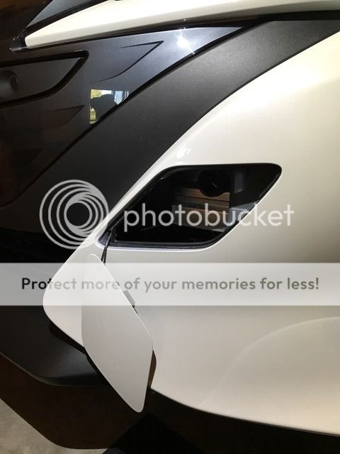

    I took delivery of my 2017 Prius Prime on Saturday, and when I got home I noticed that the front, left (drivers) side tow-hook cover was a little loose. I also saw posts in the forum of people losing these over time.
    I decided to do some quick engineering.
    The tow-hook covers are held in place by two plastic catches (hooks) on two sides of the cover. The issue that I found with mine was the inside (center) hook was not engaging the frame as tightly as it should.
    (1) open the hood

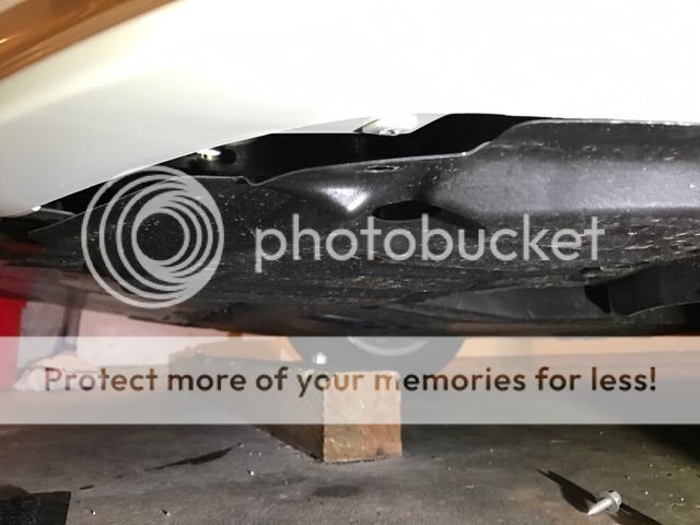

    (2) remove the lower access panel with 6 screws using 10mm
    (3) reach behind the front bumper to "pop out" the tow-hook cover

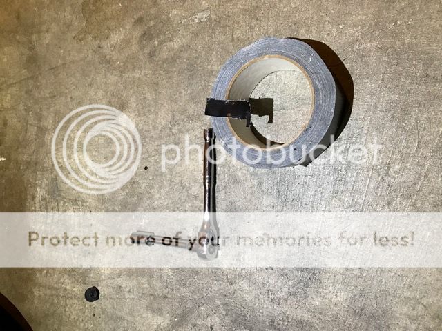

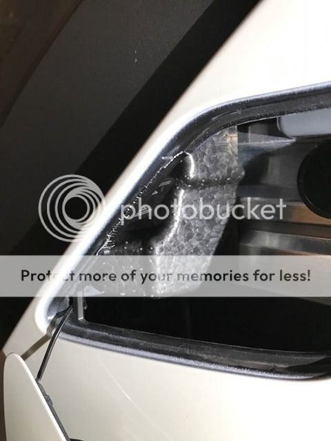

    (4) install two pieces of (black preferred) duct tape - approx 1/4" in width - to inside of frame
    (5) tools needed - 10mm socket and duct tape
    (6) finished product fits much more tightly in the frame
    Hope this helps if anyone is having the same issue.
