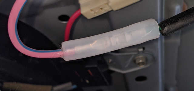

    Some pics of the connector I'm looking for and my install:
    I was thinking to wire in the switch here and cut out in the hatch trim.

    Also the luggage lamp connector is different than what the new hatch lights use in the hatch side of the wiring, so no reason to keep trying to find this random connector and will just cut these off and slice in my switch there. Probably just some spade connectors I can find in my toolbox and some tubing like you used or heat shrink to isolate it.

    And sorry for the delay, busy moving and forgot to update here. Since the connector on the original car harness didn't match what was on the harness for the lights I went ahead and cut it to put my own switch with spade connectors. I put it in the top left corner of the hatch and it's easy to reach with the hatch open. Was pretty easy to cut into the hatch trim with a sharp blade and repetitive strokes until it went through.
    Don't worry I also heat shrinked the exposed connectors on the white wire, but they're ground anyway.
