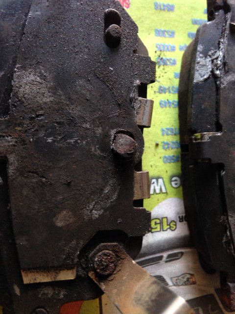

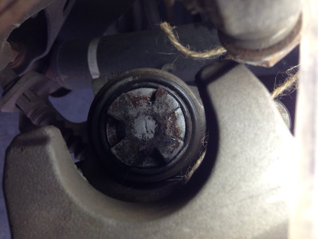

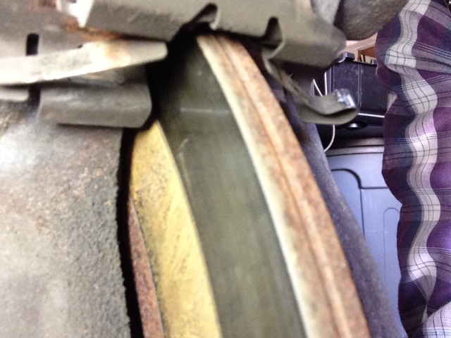

    Has anyone worked on your rear brakes? There's a pin on the back of the inside pad, that has to be in between the raised spokes on the caliper piston. If it mis-aligns, rides up onto the spoke, it'll cause the pad to press more on the outer edge (where the pin is), less or none on the inside edge.

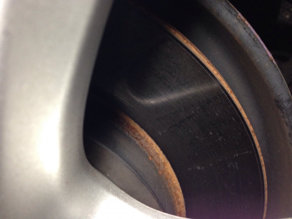

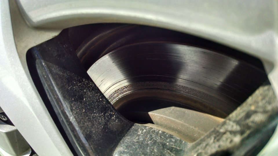

    2. Crawl under the rear (there's enough room without raising) with a strong light, and check the inside face of the rear disks. There's a slim gap between the dust cover and caliper, just enough to see the inside face condition. If there's a misalignment of that pin, you'll likely see a rusty, unused zone, towards center of the rotor.

    A few pics, #4 shows rusty zone on rotor, what misaligned pin can do:
    (excuse the mis-rotation, IPhone jpeg format messing everything up)

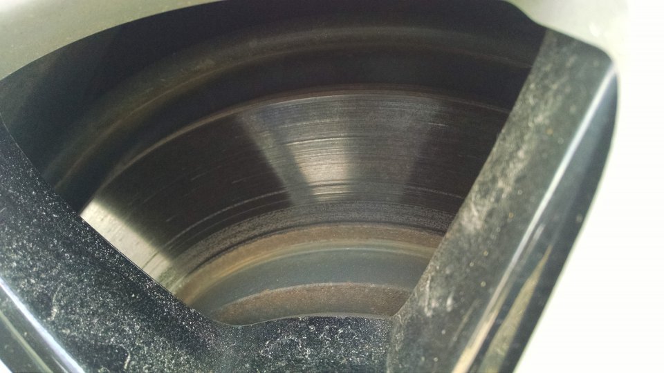

    #2, outer pad, kinda pitted:

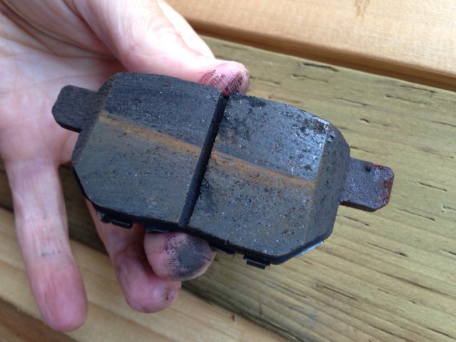

    #3, inner pad, note unused zone:
    #4, inner face of rotor, note rusty (unused) zone:

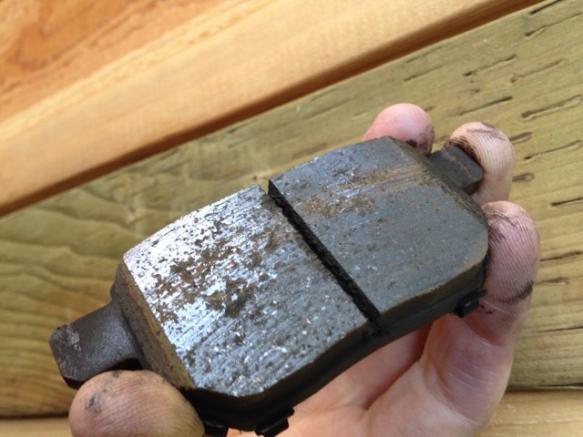

    #5, Piston face:

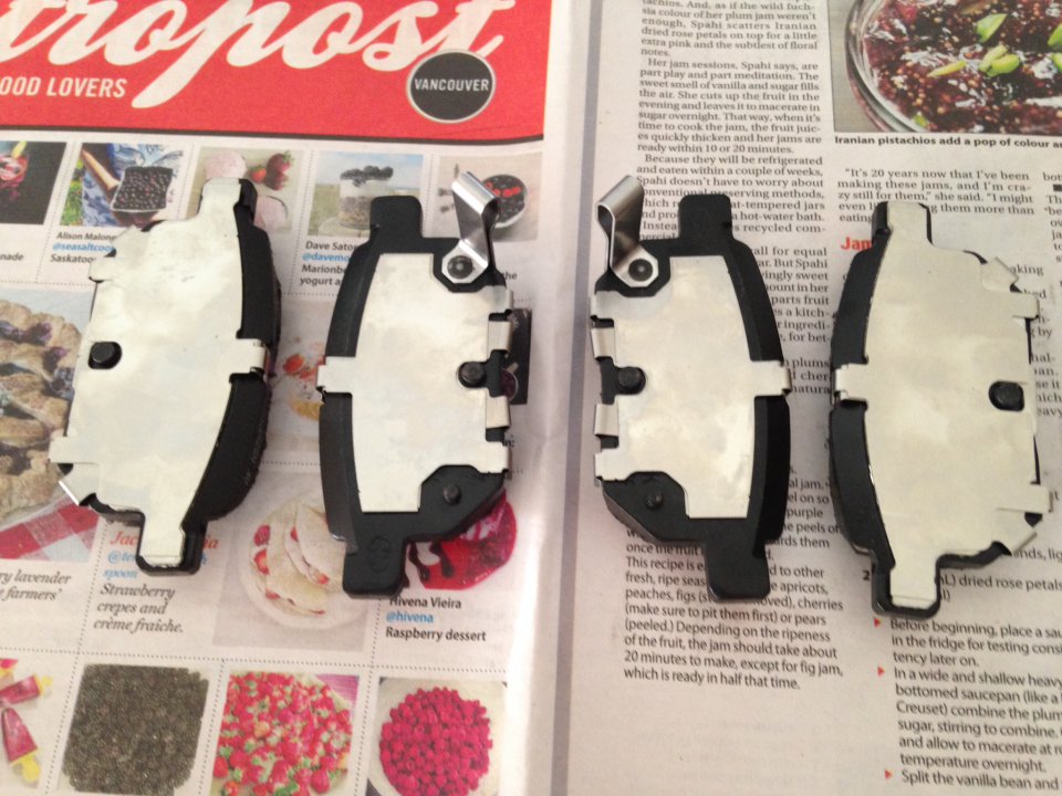

    I ended up deep-sixing the above pads, and replace with nice new, shiney clean ones. I suspect what happened was they got misaligned when a body shop replaced our rear suspension, the pin and spoke thing. I also took the rotors off, and opted to just clean them with steel wool. Better would be machining, but they seem to have bounced back. When I first put everything together and test drove, they sounded nasty, I guess the new pads burnishing the previously unused zones on the rotor. That smoothed out completely in a few days.
    Shiney new pads ;) :
    You can see the pins, on all pads, but only the inner ones utilized (the pads with handles)
    refusedone, Robert Holt and frodoz737 like this.

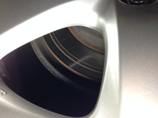

    This is the same rotor you see in pic #1 above, looking thru spokes, just now. No machining of the rotor was done, basically the pads cleaned it up.
