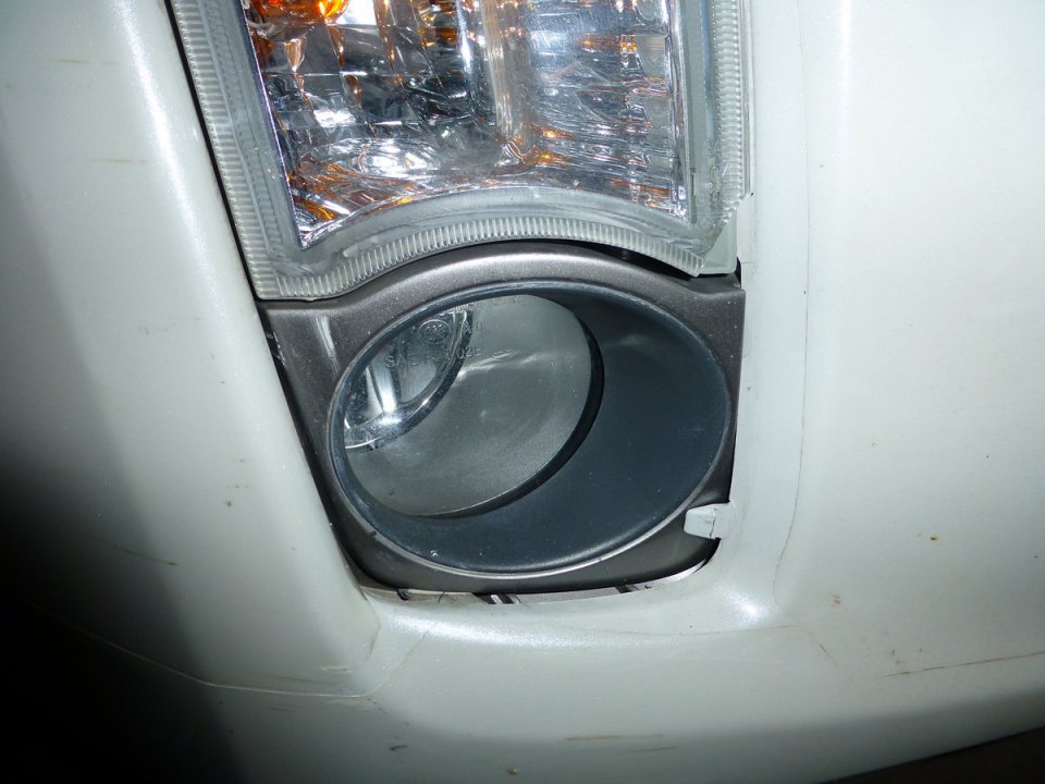

    Prius hit on right side of bumper, pushed it forward and popped the Fog Light back behind the cover. How do I get it forward of the cover again?

    Sorry about the booboo. You will need to work from the backside. Remove the undercover in that area and remove both light assemblies. Are you going to repair or just put back?

    I will just repair, the bumper cover was just pushed forward off it. Does not look like there is damage to the lights. Right now it is too cold to examine it to closely. The present temperature is at 2100 hrs just 12 degrees F. I am in Washington state, it is in my garage but it is still too cold.
    Does anyone have a take apart diagram of the area?
