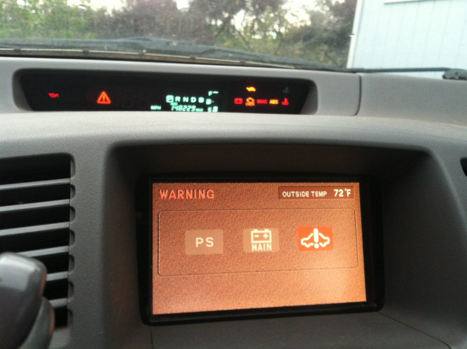

    2013-11-07 17.14.19.jpg @ bwilson4web and @ yotatoter The DTC's are the same now (post polarity reversal and hv replacement) as they were before any of this started. Might the computer be giving "residual" codes?
    I ask because I put a new harness in the HV battery when I put the remanufactured cells in, so all sensing wires are brand new. Before I take the HV battery back out to search for a faulty sensing wire, I just thought I'd ask about "residual DTC's."
    P.S. If it helps any, here's a photo of what I see when I turn the ignition to on. The HV battery also releases a faint humming sound.

  7. bwilson4web
    29,063
    16,523
    You're right:
    • 120A at battery
    • 100A at inverter

  15. bwilson4web
    29,063
    16,523
    I would recommend getting a 'repair' scanner because it will show more metrics than a traditional scanner:
    • miniVCI - uses Windows XP although some report getting it work on more modern versions.
    • AutoEnginuity - a little more expensive, it has TechStream capabilities. Be sure and get the Toyota option.
    • TechStream Lite - the gold standard, some sort of 'rental' licensing, I don't have any experience with it.
    These scanners will show more details including the subcodes of the inverter. But I'd like you try one quick test:
    1. Try to start
    2. Turn back to IGN
    3. Try to start again
    There is an obscure signal that goes from the inverter back to the traction battery, safety interlock switch, and then to the HV ECU. When I say obscure, I'm not whistling Dixie as I've not been able to tell if it is AC or DC. Regardless, if it is broken or failed, the car will not initially start. But the second attempt after returning to IGN works.
