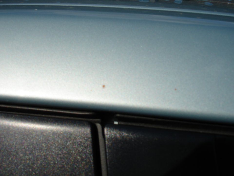

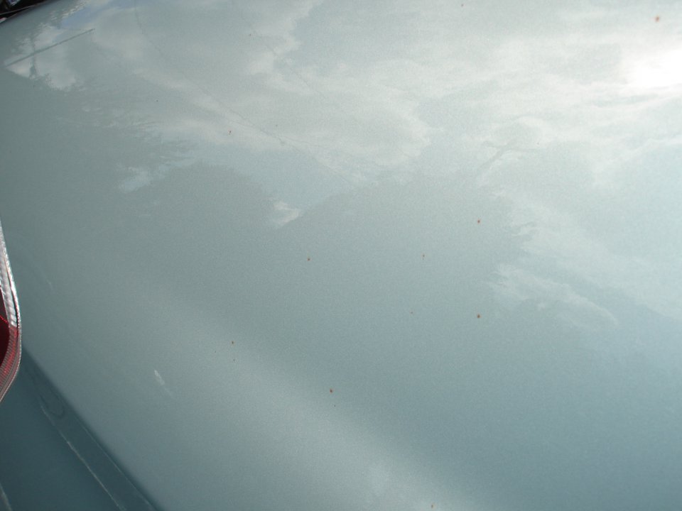

    Hey Everyone,
    My car is just over a year old now and it was pointed out to me while at the dealership that I have lots of tiny rust spots all over my car. I looked up it and it could be 'rail dust' I do park near a train station sometimes but the rust spots are ALL over the car. I'm wondering if anyone has had the same experience and if this is covered under warranty?
    While at the dealership they just said to me "You better get that fixed" but didn't even offer a solution.

    First you need to find out what it is and where it is.
    If it is on TOP of the clear coat, then it likely is "rail dust" or something else that just looks like rust.
    If that is the case, a good cleaning and polish should make it like new again.
    Rust does not "attack" paint, only metal.

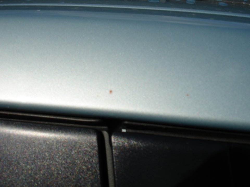

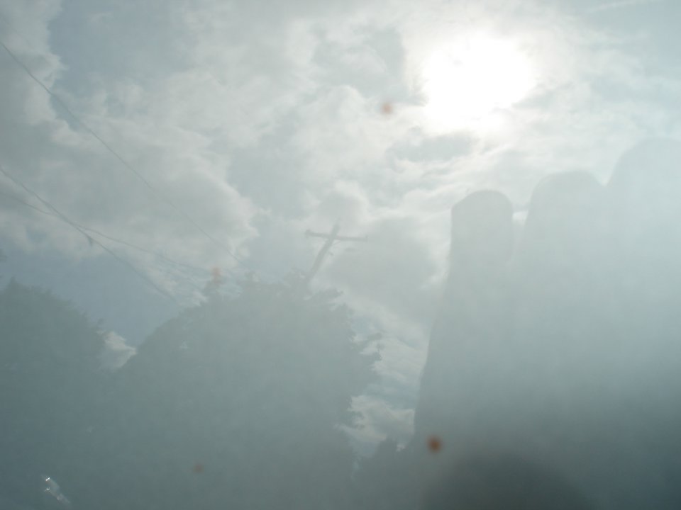

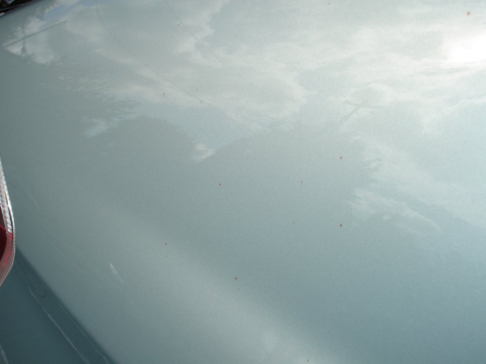

    Do these rust like spots look like the pictures attached at the end of the quote below?
    Here's the thread where these pics were posted:
    Fatally Disappointed--The Thread I never wanted to write. | PriusChat
  5. The Electric Me
    The Electric Me Go Speed Go!
    May 22, 2009
    9,083
    5,801
    Undisclosed Location
    To the OP...good luck.
    I got ZERO support from my dealership or Toyota in resolving my issue either.
    Infact, The Dealership left me with my only option being (in their opinion) live with them, or repaint the vehicle. At my expense.
    Finding the right people...with the right skills was the key to my resolution.
    Took my vehicle to numerous detailers and paint shops...most had no idea what the problem was, or how to resolve the issue.
    When I was just about to give up, FINALLY found a shop that knew how to remove the spots. They weren't rust coming up from underneath in my case. SOMETHING did get on the surface.
    Exactly what it was? Nobody ever was able to really ascertain.
    Something, somehow, sometime got on my vehicle...and it was evil enough to work it's way underneath the Toyota Clear Coat.
    Not impressed with Dealership Support or Toyota support in this matter. Also not impressed with the durability of Toyota Clear Coat. Whatever it was that got on my vehicle pretty easily worked it's way into the clear coat.
    The regional rep...had no idea what the problem was, and his solution (an acid wash) was totally useless.
    And I discovered that once the fabled Toyota Regional Rep makes a ruling about your vehicles condition and coverage? It's written in stone.
    If I had listened to the dealership, I would of either just lived with the spots for possibly years, and the diminished value they create, and/or I would of paid thousands of dollars to have the whole vehicle repainted.
    Without seeing the spots...my advice would be try detailers and paint shops, until you find one that believes they are removable.
    You'll get a lot of resistance because I think a lot of detailers/body shops are really hesitant to touch the paint on a new vehicle.

    Just sayin' but it doesn't have anything to do with Toyota or the dealer. You got metal dust on the car, and it damaged it.
    Someone across the street who was grinding on a piece of metal can cause this. It also isn't a problem with the Toyota paint. When a piece of metal dust settles on the car, it won't do anything while it's inert, but as soon as it starts to oxidize, there's a chemical reaction that will stain the paint. Same thing happens with a metal sliver in your eyeball. Wait a day to go to the doc, and just getting it out isn't enough; they have to grind out the stained rust ring.
    See this kind of paint damage all the time. If you live by a rail yard or busy tracks, you're double screwed if the wind isn't in your favor.

    Your title is misleading. You don't have rust, you have fall out on your paint. This is no fault of Toyota. They don't have any control of what may be in the air. How often do you wash your car? If not once a week, that could be your problem
