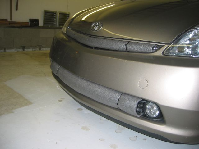

    Very short journeys are ideal for an electric car, as there is nothing to warm up. The Prime may be worth trying as your next car; it has 25 miles of electric range according to the US EPA, (40 km) but can use readily available gasoline (petrol) beyond that.
    Mendel Leisk mentions a Block Heater, you may also wish to try grill blocking in colder weather. Newer Prius have built in grill shutters that open and close as needed. Owners of older cars have to remove them by hand in warm weather.
    Here is an example, a hardware store locally should have them
    www.amazon.co.uk/Climaflex-Insulation-Length-I-D-35mm-Thickness-13mm/dp/B01BVVDJF4
    #6 JimboPalmer, Oct 5, 2019
