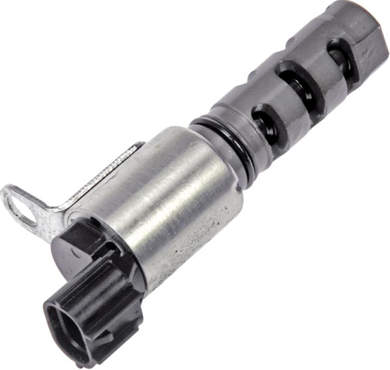

    To be safe I bench tested the VVTI solenoid. it opened and closed freely. (youtube video on how to test)

    The vvti is supposed to move some inch, when you bench test it with a 12volt battery. If it doesn't move, it isn't working.
    But the code you posted here, seems to be related more to an electrical circuitry problem on the vvti or so area

    I checked the oil control valve by pulling it out and putting 12v from a battery charger on it.
    the valve opened and closed fast and smoothly every time power hit it.

    Also, I could have fried the solenoid when I applied 12v/2amp direct from the battery charger to test it... I don't know.

    I saw this interesting video on how to replace a Variable valve timing oil filter
    that filter seems to be below/before the solenoid. it could be that there is no oil getting to the solenoid.?
