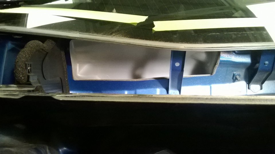

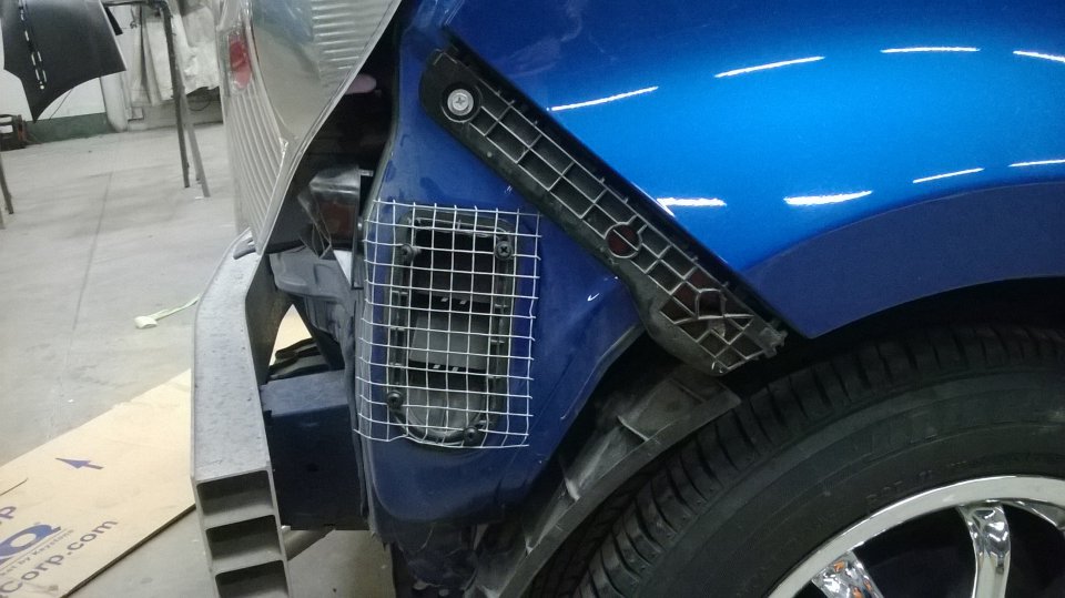

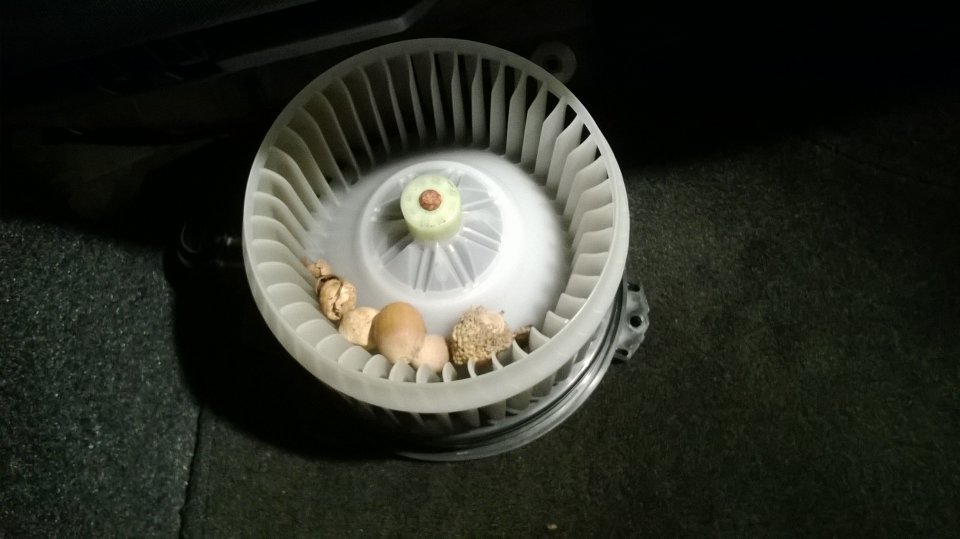

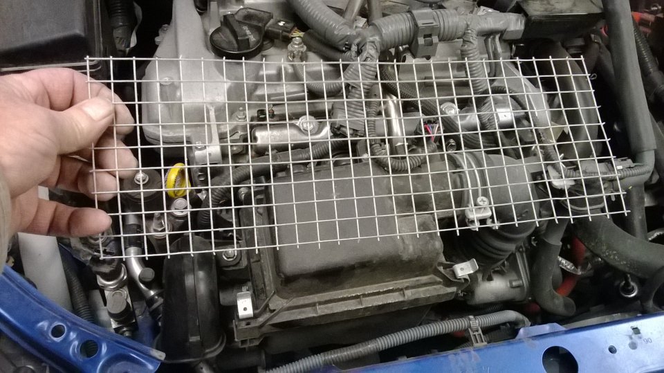

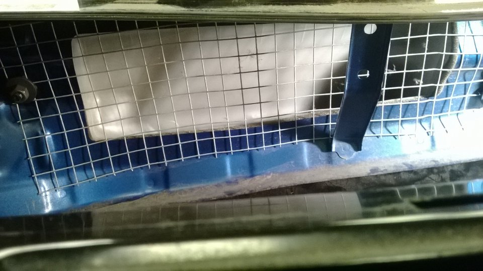

    Yes i know it sounds crazy.turn on my heat the other day, fan was real noisy, so before i took my c to dealer i would drop fan motor look for myself .what i found was squirrel's stached acorn nut's in my squirrel cage.(see picture) ya it sound's like it should be normal but not in a car.broke through filter . a remedy was in-store, so i removed cowl cover, wiper's were a little tough,i removed nut's and rocked wiper back and forth until they released. coulple clips later and it's off .as you can see there was a 12-5 opening a cat could fit in.(see picture)so i cut some chicken wire to fit 'there were a few studs there allready to attach it too.(see picture) i also put some wire on rear of car under bumper were mice could get in.(see picture) took me about 2 hours total. good luck Jim [​IMG][​IMG][​IMG][​IMG][​IMG]
