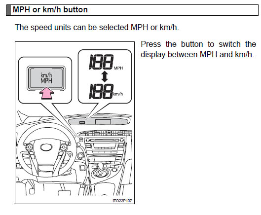

    One page 183 of (2010) Owners Manual:

    This has been answered, but they are looking for the MPG to l/km or some such... plus... our car doesn't have this button.

    Sorry, lost track of this being the c forum.

    10,706
    Those instructions are probably specific to the 'c', not your PiP.
    I don't have a PiP, but suspect it is more similar to my Liftback. Is there a cluster of three buttons just to the right of the steering wheel, to adjust the clock and speedometer? One of them should have a Km/miles marking, press it.

    What fuzzy said. If you think about it, a dedicated button is virtually necessity: you do NOT want to be wandering around in menus looking to switch something that fundamental.
