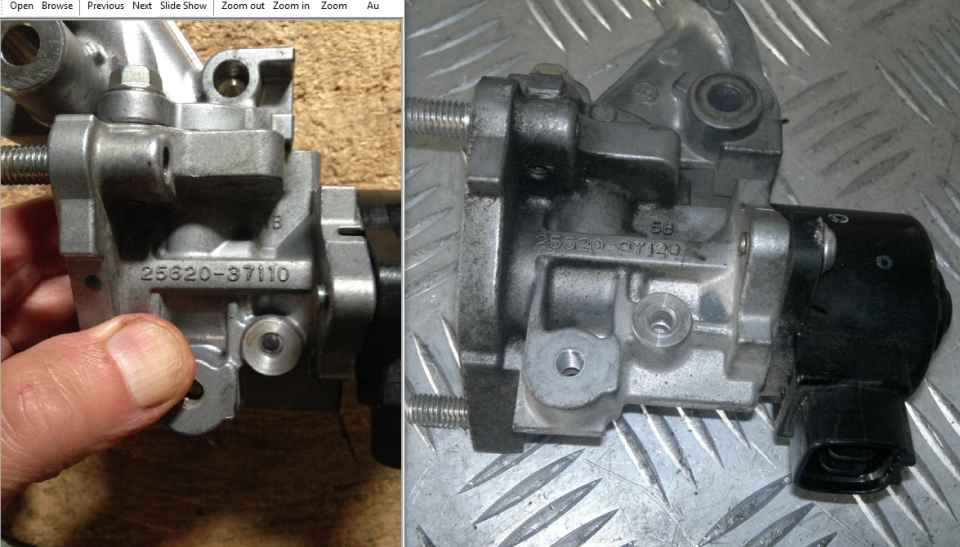

    Aha! T-SB-0075-13, for those following along at home. I hadn't spotted that one before. Good catch.
    We have surprisingly little information about what changed between the -37110 and -37120 valve. People swap them and even get asked to please report the differences and aren't heard from again.
    The only visual comparison I've seen is Mendel's:
    Definitely taller, and I think Mendel's right about the wire harness mod. The existing electrical tape on the harness is cut to give a bit longer reach to plug in to the valve. The bit of added tape is just to make sure the stretched out section won't rub on the zip tie.
    T-SB-0027-16, and because the revised valve made its own appearance 3 years earlier, it seems the firmware change is not something strictly required to drive the revised valve. Beyond that we don't know what the firmware change did.

    Just for the record: in my pic above (the one with a thumb), I believe I've got the EGR valve sub-assembly reattached the wrong way 'round.

    Longer in the direction of pintle travel, same as Mendel's paired photos showed.
    But is there anything different about the pintle or the bore? Is the thread pitch on the shaft any different?
    If they are to work with the same firmware, it is going to think 111 steps of the magnet rotor is the total range of motion for each valve. (Or whatever the number is, I think I remember 111.)
    If they went to a steeper thread pitch, they could have the 111 rotor steps move the pintle a different distance.
    What's the extra small hole in the mounting face of the old one, that is blanked off in the new one?

    There is an extra small hole in the mounting face of the old one. It looks like a lubricating point for the spring shaft. Got some wd40 and sprayed the hole which made the shaft easier to push down because of the lubrication.
    As for the thread points, nothing has changed in addition to the length of the shaft and pintle bore

    \ I did a measurement from the EGR valve rear flange, to underside of the black cap, on my old version: roughly 2-3/8". Pic isn't that clear, just to show where/how I took the measurement:
