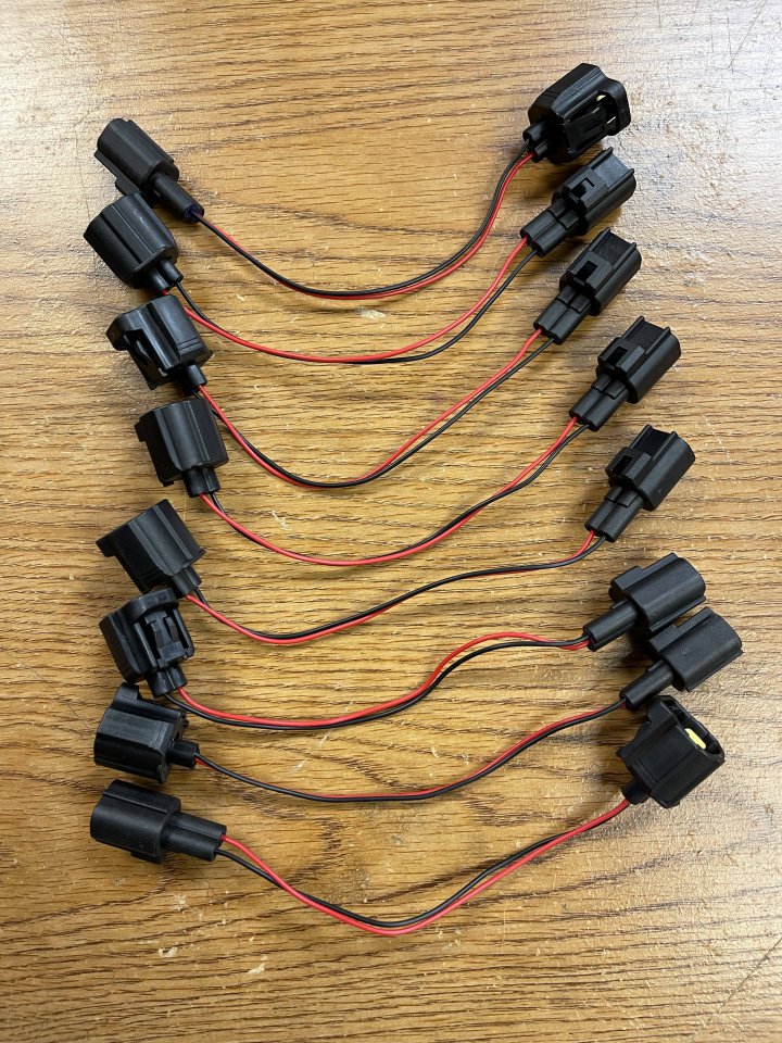

    RightOnTimeSenior Member
    Start a Conversation
    Sep 21, 2012
    589
    1,394
    183
    Kidnapped in OC, CA
    Since our Shop has done so many of these transplants, I decided to piece together a harness that is plug and play to extend that dang water temperature plug sensor. If anyone is interested please contact me at: [email protected] [​IMG]
    $12 which includes free shipping in the United States
    #992 Ragingfit, Sep 13, 2021

    Nice! how do I get one?

    Ahh, kind of late now. I was able to solder a 6" piece of wire and extend the connector. May be for the next project I'll pick up one of the above harness.

    Package is on its way to you!
