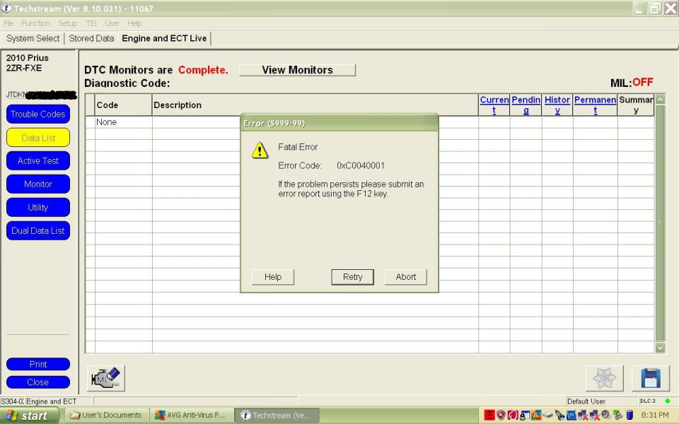

    Thanks, but I figured out how to do it already. Last night I was able to download the newest version 8.10.0021 and make it to work with hacked MainMenu. It was hard to find though. You are right, I haven't detected any malware yet.
    The only problem is the hardware I was sent has the lesser firmware 1.4.1 and has problems communication with gen3 prius with fatal errors. Works fine on the other toyota cars I have. Bob previously described the issue here: MiniVIC . . . may have a problem | PriusChat but I didn't see it before ordering the interface.

    I tried the hacked TIS again with and without AV and there is no difference in function.
    I'm still getting this on engine data list:

    As long as you successfully installed the driver, I would still recommend purchasing the TIS subscription. I really can't tell if it is some kind of conflict with the software being hacked, no connection to TIS server, a problem with the MVCI itself, or a combination of. It would be easy to rule out the software if you subscribed and downloaded a copy. Then you could also rule out not being connected to TIS server as well because you have an active subscription. (I didn't really do much besides activate the alarm and attempt to activate the remote start, but my hunch is that it is not the MVCI. Most are a standard pass through connection type which is highly reliable to my understanding.)
