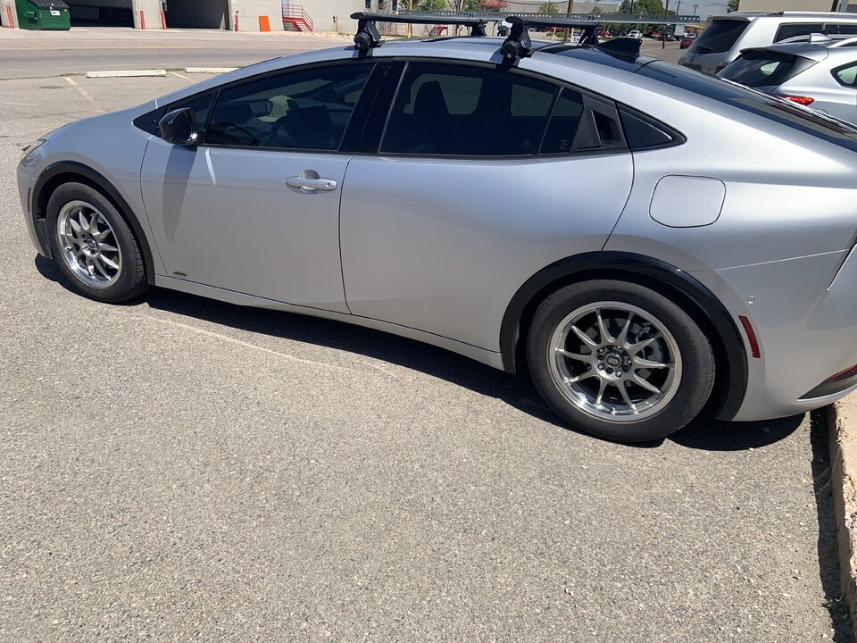

  8. kev604
    kev604 Junior Member
    Nov 2, 2025
    56
    Vancouver, BC Canada
    2026 Prius Plug-in
    I've always had a soft spot for bronze wheels.
    My winter set up 17x7 +45 on 215/55/17 Michelin X-Ice Snows

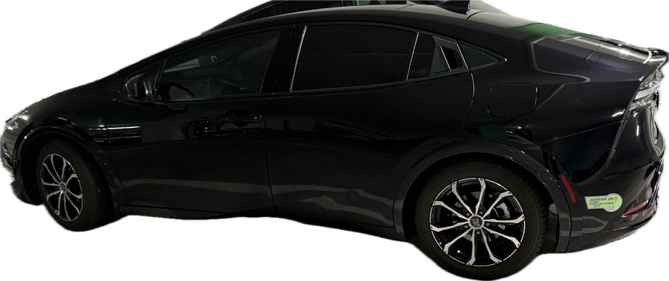

  10. Yaktastic
    Yaktastic Junior Member
    Mar 17, 2025
    2024 Prius
    2024 Prius XLE with 225/55r17 Verdestien Quatrac Pro+ mounted on 17x7+40 Borbet Type W wheels (anthrasite).

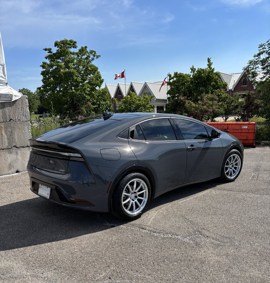

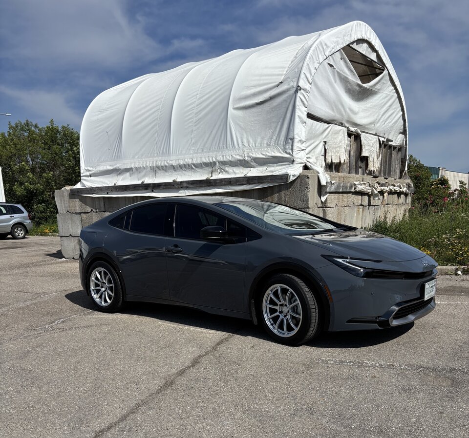

  12. Brick317
    Brick317 New Member
    May 22, 2026
    Toronto
    2026 Prius Plug-in
    XSE Premium
    225/50/18
    18x8.5 ET35
