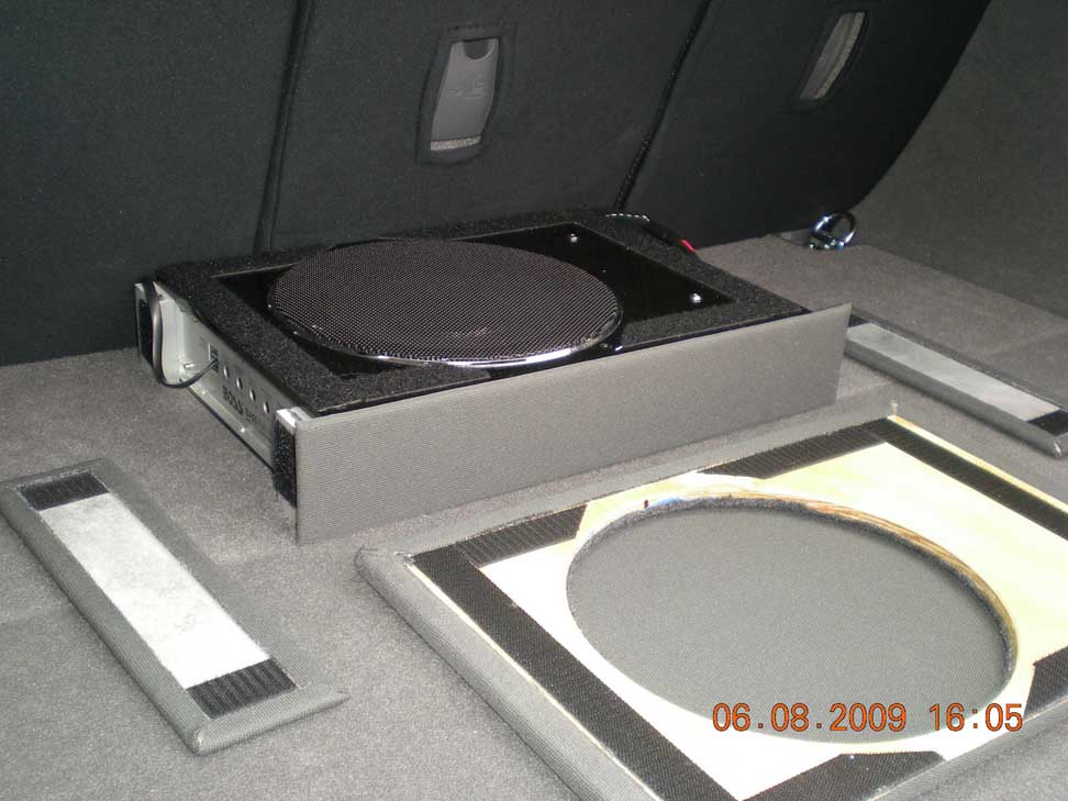

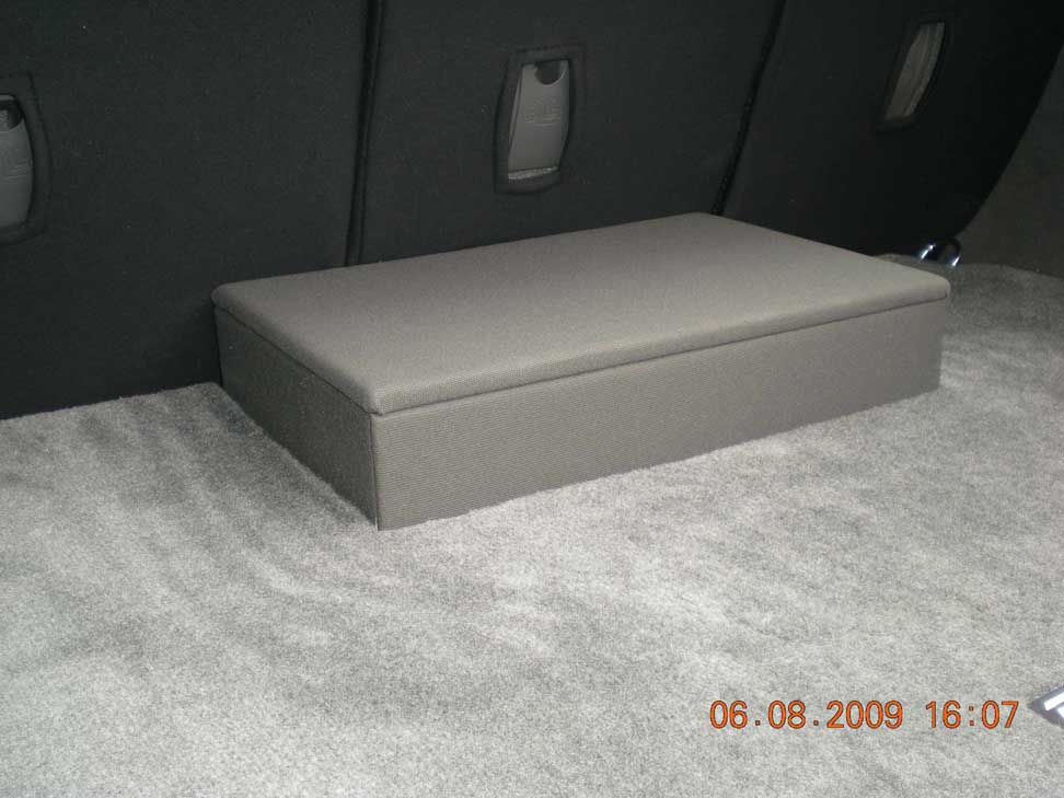

    I have been using a BOSS BASS800 for the last everal years, it still works fine!
    I just covered it up so it blends in with the rear area! As for suggestions, run both + & - to the 12v battery, The sense line can come off the cig lighter as they power off when the car is off. I ran 2 conductor shielded wire for the inputs, grounding the shield only at the input ground. That helps keep stray noises out of the unit. As long as you don't drive the crap out of it, or demand unrealistic SPL's from it, it works just fine! I just played a tune that starts off very bass heavy, I had forgotten how good the unit worked, when the song was over, I played it again!

  8. KK6PD
    KK6PD _ . _ . / _ _ . _
    Mar 24, 2008
    4,003
    946
    118
    Los Angeles Foothills
    I considered it, but the map DVD is under the drivers seat, the JBL amp is under the passenger seat. I thought things were too tight, and neither my wife or I wanted to sit in a seat the was buzzing to the music! Dead center back where I stuck it was my third best choice! I milled some custom corner mounts, got rid of the rubber bumpers, those were way too flimsy!

    Oh, and KK6, is that a Boss 600 or 800? You say 600 here over at [I'm not allowed to post full links yet] /threads/installing-a-subwoofer.77746/#post-1085299
  10. KK6PD
    Mar 24, 2008
    4,003
    946
    118
    My bad, typo, I have the 600. the only difference is physical size. Install is the same for the 600 & 800!
